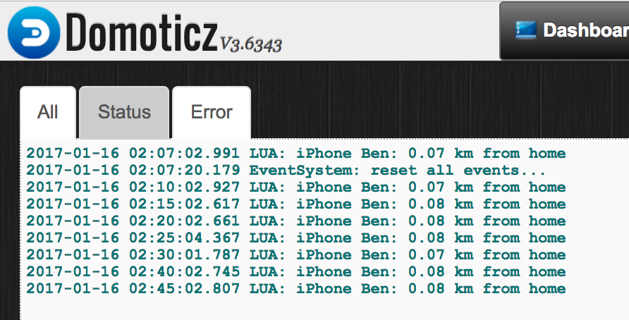

You should see it updating in the status log tab:
Remember the Position text string will only update if you go outside the set area.

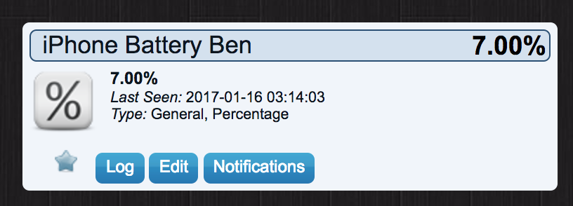

This version also gets the iPhone battery level, which is really cool cause Domoticz can chart how long my iPhone lasts on battery power.
Just add a percentage sensor device called: iPhone Battery USER (in my case USER is Ben)
