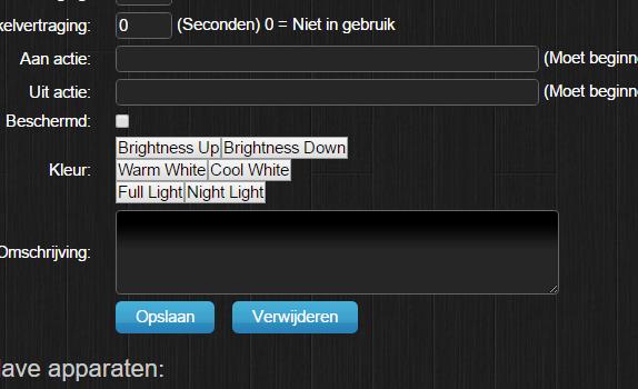

new white bulb...
You make the install easier great work!!!
Only one thing, the option are not working?
Bright and night etc does not work...
Is there anybody that have the HUE and the different scenes functions working?

Post by corbin »
Compile my fork on GitHub where I've added in brightness up/down etc
