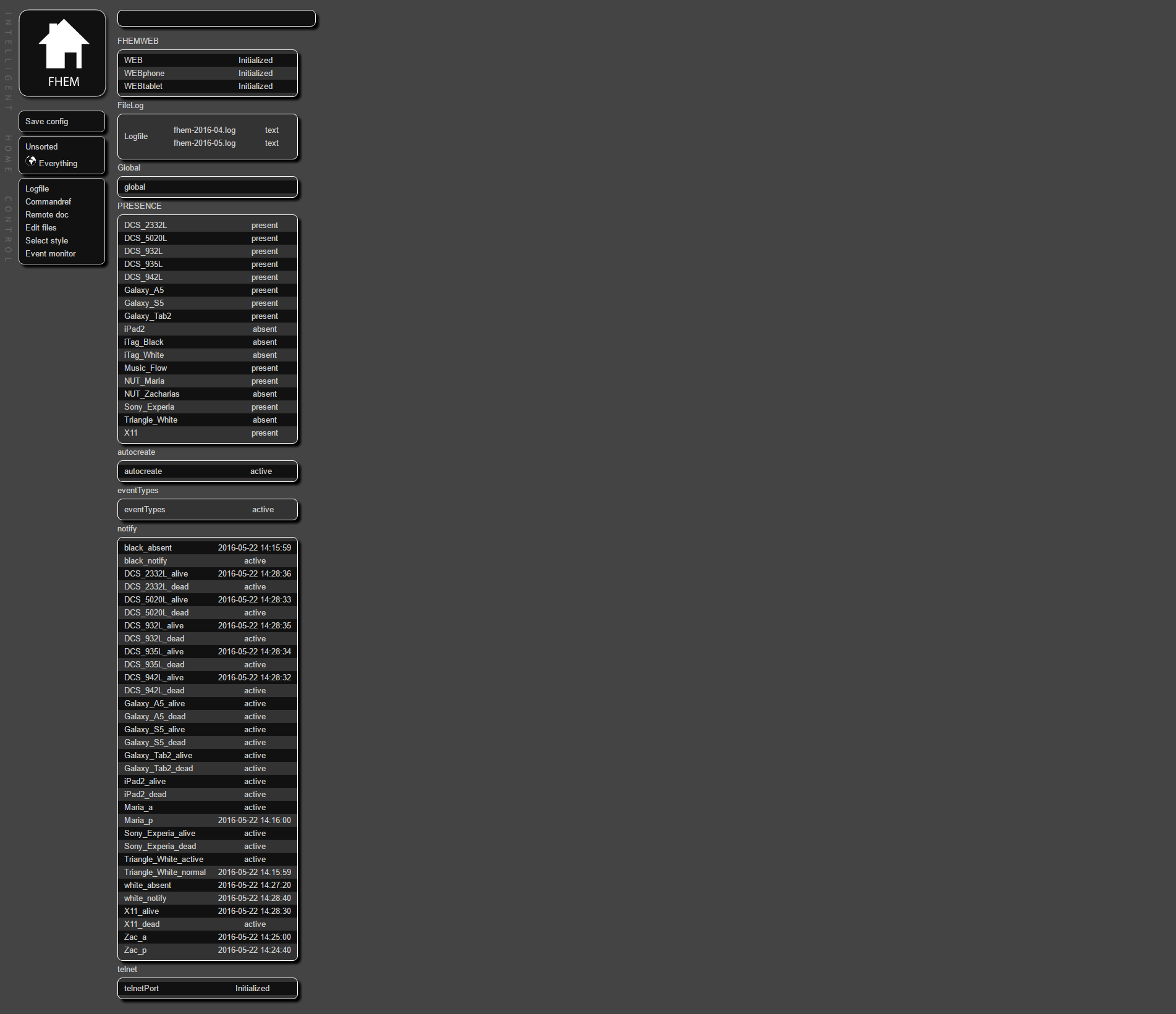

Still I have FHEM as prefered solution as it supports even more PRESENCE types (wifi, SNMP, BLE remote/local). it is 100% stable and memory footprint is so small. The delay is less than 3 sec!
The only issue is that community is german speaking so for people that do not understand German, google translate is their friend. :lol:
Also it did not read battery or button status of beacon which would be great to have.

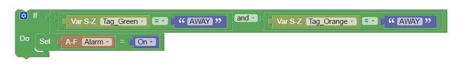

This is what I want. When I (Tag_Michel with device IDX 23 ) am not home I want a switch to show AWAY and the same for my wife (Tag_Vanessa with device IDX 20). Obviously I'd like it to show 'HOME' when I am at home. When both me and my wife (Tag_Vanessa with device IDX 20) aren't in the house I want the alarm to trigger to 'AWAY'. Also when I come home I want a TTS switch to welcome me home with some news.
Is there a way to do this w/ Blocky? I have build 2 virtual switches, but they don't show an off and on state.
Thanks again for your patience and help...

If you want to go into alarm and TTS things, I advise you to start discover Lua. You 're going to struggle a bit several days, and then you will go much more far than with blocky.
However , that is a starting point in blocky :

Don't take it wrong, but I like to share the experience I have using FHEM.
I just installed another raspberry to the rooms that NUT get out of range. I installed on the new raspberry (slave) a bluetooth dongle and followed the guide on http://www.fhemwiki.de/wiki/Anwesenheitserkennung
On slave device there is no domoticz required of full FHEM installation! just 3 services to run and using collectord I can now walk around home without losing the presence flag. As FHEM supports rooms, now I know where any bluetooth device is present! So for the panic buttons it is usefull to know where button is pressed and run different scenarios (if it pressed on bedroom, turn on the bedroom lamp etc). :D
Next step: Add an extra raspberry or lower power device to garden attached with usb bluetooth dongle, so I can get garden lights turned on/off.
