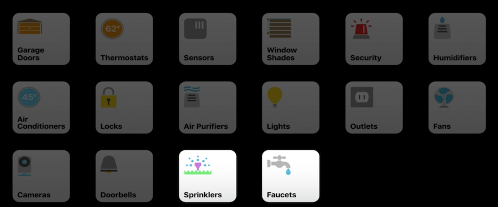

Hi all! With iOS 11 Apple gave support to faucet and sprinkler.
Witch device I have to choose in domoticz to show them in Homeapp?
And witch device I have to choose in domoticz If I want to show the electric socket icon in Homeapp?
Thank you
Thank you
Re: homebridge-edomoticz Plugin
It will be nice also to have the other ones missing. Humdifiers and air purifiers along with Faucets & Sprinklers
- Ios11.png (170.73 KiB) Viewed 5672 times

Yes, also like the air conditioners or thermostat. Outlets witch type are? Because if I use selector or on/off it appear like a button or lamps, not outlets.morilm wrote: Wednesday 20 September 2017 21:17 It will be nice also to have the other ones missing. Humdifiers and air purifiers along with Faucets & Sprinklers

@marcotini on the home app you can select with type is a switch (light, switch, fan).
