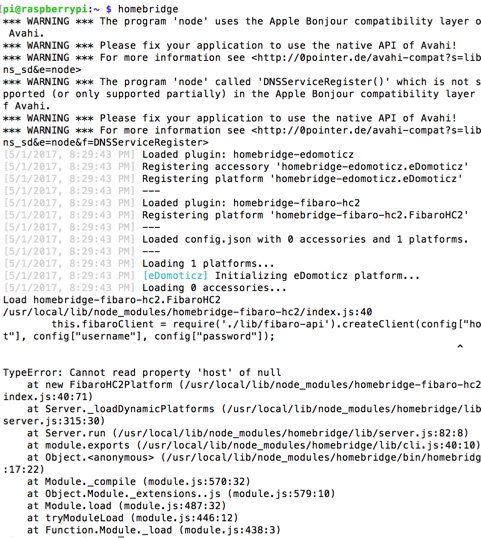

Unfortunately I still can't get it running. If I run homebrigde on my pi. This is what I see.
It states loading 0 accessories. That can't be right can it?

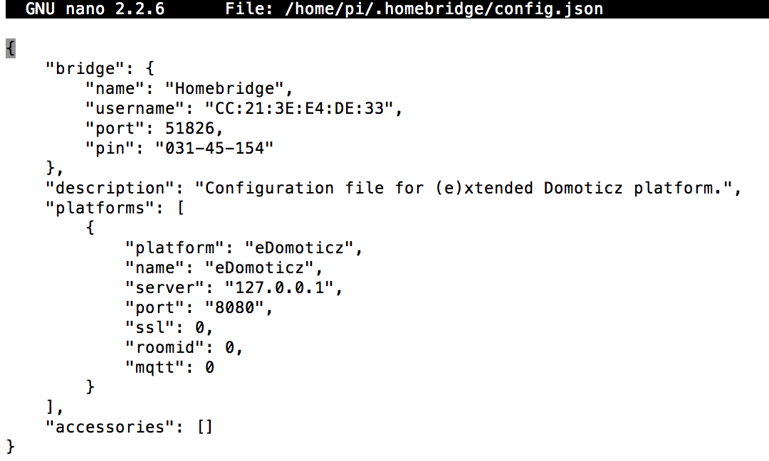

This is my config.json
Schermafbeelding 2017-05-01 om 22.48.36.png (76.34 KiB) Viewed 5084 times

Hi Nederveen, the config looks fine, did you check the stuff I sent you? According to the log it seems something goes wrong with the fibaro, do you have other devices as well?

Nederveen wrote:PastedGraphic-1.png
I did so when it did not go
delete folder ~/.homebridge/persist
change code pair
reboot

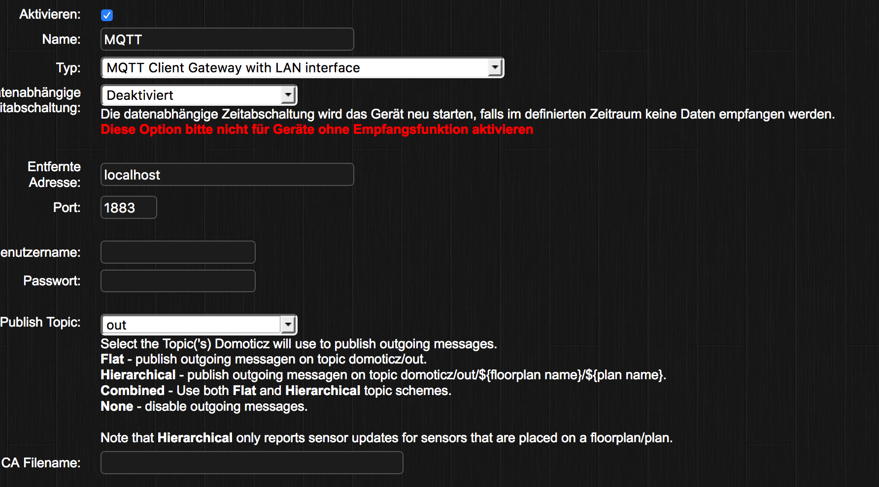

HI I am new to Domoticz and trying to get homebridge connected, however I am always getting:
[6/5/2017, 10:21:42 AM] [eDomoticz] Retrying connection to MQTT broker...
[6/5/2017, 10:21:42 AM] [eDomoticz] Could not connect to MQTT broker! (localhost:1883)
I am lost where did go wrong, added MQTT
[img]
[/img]

by theo69
The MQTT Broker was not installed properly, now i got the connection!
