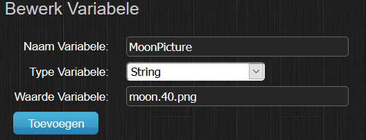

EdKo66 wrote:Will I make this in the tab setup/More Option/User Variables?. If so, I get an err[rror]
Indeed, you need to do it that way. I wonder what causes the error then :shock:
Does this explain a bit more? BTW. The value of the variable is not really important when creating...
Same goes for MoonphaseCheck. That's a string variable as well.
Can you explain where the error occurs?
Wizjos

I think that was the problem, indeed. Didn't know what to enter, tried it with and without anything in it. I used 'integer'. Now it seems to work.
Awaiting the update to really use it
04-22 16:12:00.461 LUA: script bin_selector executed
2017-04-22 16:12:00.504 LUA: MoonPhase - Update not allowed: Difference is 73 seconds
2017-04-22 16:13:00.192 LUA: script bin_selector executed
2017-04-22 16:13:00.201 LUA: MoonPhase - Update not allowed: Difference is 133 seconds

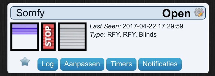

@Robgeerts,
I still have the issue with the blinds and showing the STOP button. For that I've consulted the manuals from Fibaro and Qubino. There are 3 main types, which are defined in Domoticz:
  • Blinds (normal up - down)
  • Blinds percentage (up - down & percentage up/down)
  • Venetian blinds EU (In dutch: jaloezieën - EU Variant)
Furthermore there a several derivatives from the 3 main types:
  • Blinds inverted (normal up - down -> inverted)
  • Blinds percentage inverted (up - down & percentage up/down -> inverted)
  • Venetian blinds US (In dutch: jaloezieën - US Variant)
Only the Venetian blinds have the ability for the STOP function. For the blinds and blinds percentage the STOP button is not working (correct). The only thing that happens is no STOP, but a revert action (if going Open than Close / Close than Open).
I made an inventory of types, so maybe it's possible to make a correction?
BLINDS
         "AddjMulti" : 1.0,
         "AddjMulti2" : 1.0,
         "AddjValue" : 0.0,
         "AddjValue2" : 0.0,
         "BatteryLevel" : 255,
         "CustomImage" : 0,
         "Data" : "Open",
         "Description" : "",
         "Favorite" : 1,
         "HardwareID" : 2,
         "HardwareName" : "Aeon Labs Z-Stick GEN5",
         "HardwareTypeVal" : 21,
         "HaveDimmer" : true,
         "HaveGroupCmd" : true,
         "HaveTimeout" : false,
         "ID" : "00000201",
         "Image" : "Light",
         "IsSubDevice" : false,
         "LastUpdate" : "2017-04-22 16:05:44",
         "Level" : 0,
         "LevelInt" : 0,
         "MaxDimLevel" : 100,
         "Name" : "Rolluik Woonkamer",
         "Notifications" : "false",
         "PlanID" : "2",
         "PlanIDs" : [ 2 ],
         "Protected" : false,
         "ShowNotifications" : true,
         "SignalLevel" : "-",
         "Status" : "Open",
         "StrParam1" : "",
         "StrParam2" : "",
         "SubType" : "Switch",
         "SwitchType" : "Blinds",
         "SwitchTypeVal" : 3,
         "Timers" : "false",
         "Type" : "Light/Switch",
         "TypeImg" : "blinds",
         "Unit" : 1,
         "Used" : 1,
         "UsedByCamera" : false,
         "XOffset" : "741",
         "YOffset" : "287",
         "idx" : "6"
BLINDS PERCENTAGE
         "SwitchType" : "Blinds Percentage",
         "SwitchTypeVal" : 13,
VENETIAN BLINDS EU
         "SwitchType" : "Venetian Blinds EU",
         "SwitchTypeVal" : 15,
BLINDS INVERTED
         "SwitchType" : "Blinds Inverted",
         "SwitchTypeVal" : 6,
BLINDS PERCENTAGE INVERTED
         "SwitchType" : "Blinds Percentage Inverted",
         "SwitchTypeVal" : 16,
VENETIAN BLINDS US
         "SwitchType" : "Venetian Blinds US",
         "SwitchTypeVal" : 14,

Cool! I expect it to be working smoothly now... Let's await @robgeerts' new update 8-)
BTW You can set the interval a bit lower for one time only. I don't think Wunderground will charge you for it :lol:
Edited my initial post with the remark about the uservars both being 'text'...

Well, I made an option to hide the stop button in latest version (coming tonight) ...
Can anyone confirm that ONLY venetian blinds have a stop button? I thought someone posted he needed the stop button with regular blinds...
I have blinds as type and the stop button is working.
Bestand 22-04-17 17 40 51.jpeg (45.85 KiB) Viewed 2716 times

I have tried with KAKU, stop is not working for this type.
