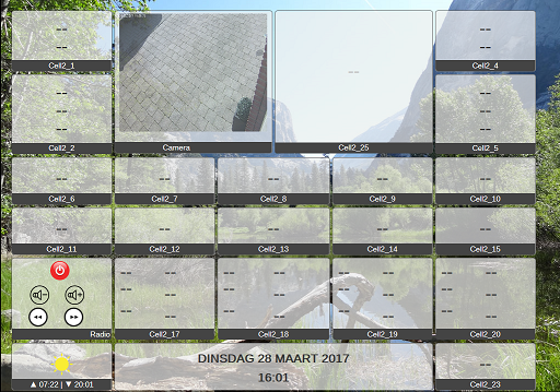

Finally I managed to get some modifications for my FrontPage.
All files can be found at: https://github.com/Xavier82/Frontpage.
The screenshots from my FrontPage, based on G3rards FrontPage, can be found at the repository.
Page 1
frontpage screenshot page1.png (373.15 KiB) Viewed 15515 times
Page 2
frontpage screenshot page2.png (371.88 KiB) Viewed 15515 times
Thank you G3rard for sharing your FrontPage.
Modifications done:
FrontPage day CSS page 1:
Enlarged 2nd row cell 2 and cell 5--> result 3 inputfields
Enlarged cell 3 and 25 to match first row height
Cell20 contains LUA script which determines when trashcans are emptied by the community.
Shows type of trash to be emptied based on time schedule (weekly and by time)
FrontPage day CSS page 2:
Enlarged 2nd row cell 2_2 and cell 2_5--> result 3 inputfields
Enlarged cell 2_3 and 2_25 match first row height
Enlarged complete 5th row. Now each cells has 6 inputfield--> Result added functions/control for my Onkyo Receiver
LUA script for "Afval" and icons for "Afval"(Garbage) can be found in the repository.
LUA script for controlling Onkyo Receiver and icons for "Onkyo receiver" can be found in the repository.
FrontPage.html:
Added cells within DIV
FrontPage.JS:
Added commands to change text to icon for "Afval" and "Onkyo receiver" (Radio)
FrontPage_settings.js
Added IDX for Onkyo
Added multiple cells which are created in CSS to assign new inputfields.
This is my first post so hope this all works :)
Feel free to use!

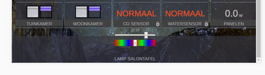

racquemis made a great slider to control RGBW bulbs but I want to make the slider larger so you can control it better, see the picture.
I spent a few hours to change the html, js or css code but had no luck, I don't have the knowledge where the lenght of the slider is defined in the code
thanks in advance
