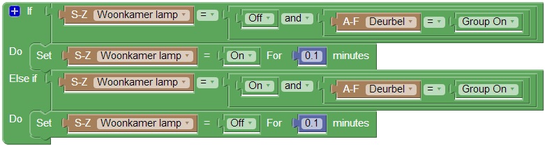

spaanplaat
- Posts: 10
- Joined: Friday 12 July 2013 16:21
- Target OS: -
Re: Events system feedback thread
I've been playing a little with the event system and it seems really easy.
However I am running into some issue's.
I'm trying to create a scenario when my doorbell is pressed a certain light turns on for 0.1 minutes if that light would be off.
If that light would be on the light turns off when the doorbell is pressed for 0.1 minutes (I also tried 1 whole minute to see if the 0.1 would not function).
When I try to use blocky it looks like I need the "group on" command, but when I check the current states it says the doorbell is already in the "group on" state.
This to me seems to be in conflict with my blocky string and as expected nothing happens. What command should I use for the doorbell?
- doorbell light.jpg (61.83 KiB) Viewed 6469 times
Funny that 0.1 minute works, I did not anticipate that, please test. I think a kaku doorbell is always "Chime", on or off, it sends Chime again when pressed. Chime status was not in the status dropdown yet, I just added it in 932.
Edit: I think your if statements are incorrect.. you pasted "OFF and Deurbell..." in the opening where you should only drop the off. Start off with 2 blocks:
woonkamer lamp = off
Deurbel = group on (must be Chime later)
grab an and block and drop in the other 2.
That way the logic will be if ((woonkamer lamp = off) and (Deurbel = Chime)). yours reads: if(woonkamer lamp=(Off and and (Deurbel = Chime))

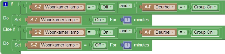

spaanplaat
- Posts: 10
- Target OS: -
Thank you for your explanation for the statements. Your method seems more logical when I think about it.
So I changed the blocks and for testing purposes I also changed the time to a full minute.
Now when I press the doorbell the light turns on and of randomly.
I think this has something to do with the status of the doorbell always stating "group on".
I had to restart domoticz as the light still turned on and off after I unchecked the event.
Kinda funny though.
It seems I still need to learn allot about the events.
Is it the way the doorbell sends the command? Within domoticz I am able to use the doorbell as a trigger to take a snapshot with the ip-camera when pressed. Is this different from the blocky method?
Kinda funny though.
- doorbell light.jpg (57.02 KiB) Viewed 6442 times
