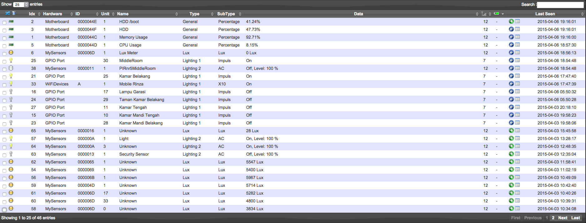

I Think there is lot of bugs lately, domoticz sometimes create new device for exiting device, screenshoot attached it creates new lux sensor several times. and also with my humidity+temp dht11 device, domoticz often create exiting humidity and temp device separately. I use domoticz 2358

Dont think this is an domoticz problem, seems your child id's are changing ? (or your node id's)
Atleast no issues here
Could also indicate problems with the serial gateway, you used the sketch as-is, or did you modify the sketch?
Could also indicate your nodes do not remember the ID ?
