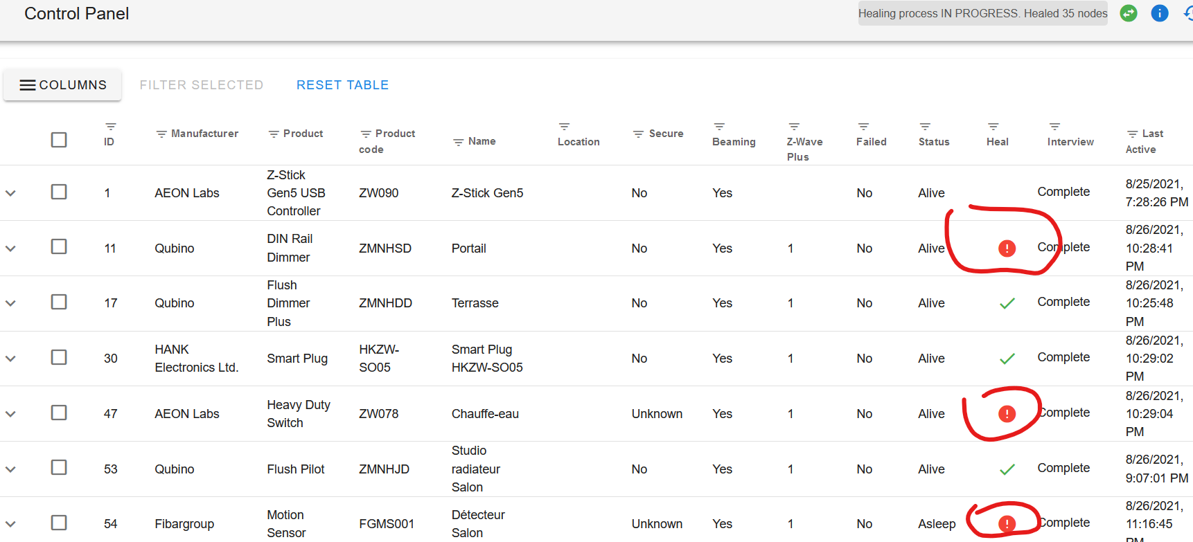

heggink wrote: Wednesday 25 August 2021 18:54 Outside of that, things working OK?
So far, I've made some testing with some switches, a sensor (temp, movement, lux): I've on/off , dimmer , temp and lux.
With some difference with OZW:
* the icon for the movement sensor could not be changed
* an "on/off" switch on a dimmer node (FIBARO FGD212) show 99% when on instead of On with OZW
I'm going to finish the rename and the classification in order to perform more testing.
I need also to understand more the Zwave To MQTT Control Panel to manage the network. At the present time, I have some issues and don't know how to do

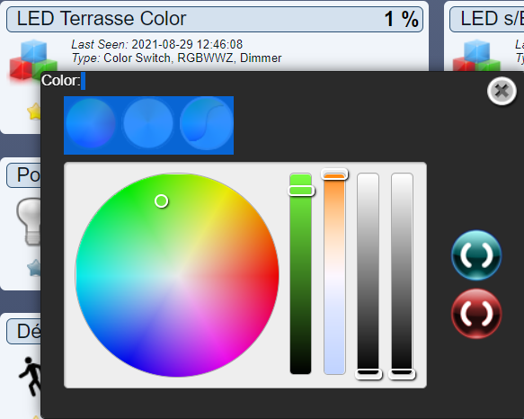

I've 2 issues with FIBARO FGRGBWM441 RGBW Controller
1/ there is no longer a device to change the color
Screenshot 2021-08-29 124643.png (101.78 KiB) Viewed 2779 times
2/ with OZW in dz, I have a script to launch a LED animation based on the "zwave hardware" and there is no longer an hardware inside dz
http://localhost:8080/json.htm?type=command&param=applyzwavenodeconfig&idx=10&valuelist=72_Ng%3D%3D
Is Domoticz able to activate RGBW animation programs?
Perhaps it is possible to do it directly on zwavejs2mqtt? How?
