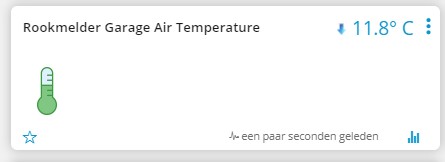

So, focus on the one in the garage here...
It was last seen 11-3-2021 at 14:09:46 and has no battery indication. Temperature was last sent a day ago. Makes sense as the detector did not respond at all, so the battery was completely dead.
Replaced the battery and IMMEDIATELY saw the temperature being updated! I took my cell phone along and this was instantly!
However, looking at the node info it DOES show it was last seen 21:35 today, but no battery info.

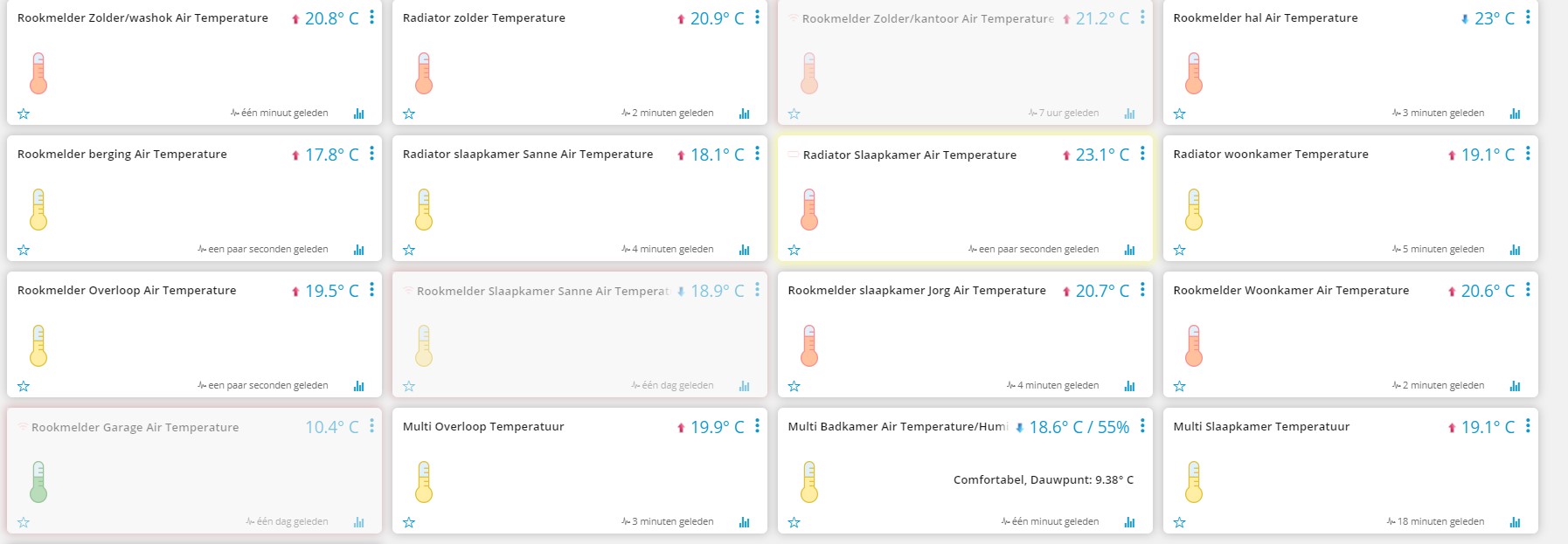

If you look at the first picture, the same goes for the one in "Zolder/washok". It was 20% yesterday and not displaying temperature data. I exchanged the battery and immediately it started showing temperature data. However, battery level is still at 20%!
I don't mind replacing batteries often. I know that is a burden of using rechargeable batteries. But then I need to be able to rely on correct level notification. This I cannot do right now. If I am being notified that it is at a low level, I can replace the battery in a timely manner. This does happen with my Danfoss radiator knobs.
And I am not talking about cheap Chinese made smoke detectors here! These are Fibaro smoke detectors!
