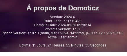

Re: Support for Somfy Connexoon and Tahoma
Post by madpatrick »
Please place the log file as text and not as an image. It is then hard to read
You can copy past it as text and then uses the backets in the files of the form.
I see that you are using version 2.02 of Norfolk plugin.
That is not the correct plugin
Infos Domoticz.jpg (29.25 KiB) Viewed 2404 times
Infos Domoticz.jpg (29.25 KiB) Viewed 2307 times

i see Python 3.10.13 in the screen shot, but Python -V gives 3.9.2
that makes no sense.
Try :
apt install python3 libpython3-dev libpython3.10-dev
