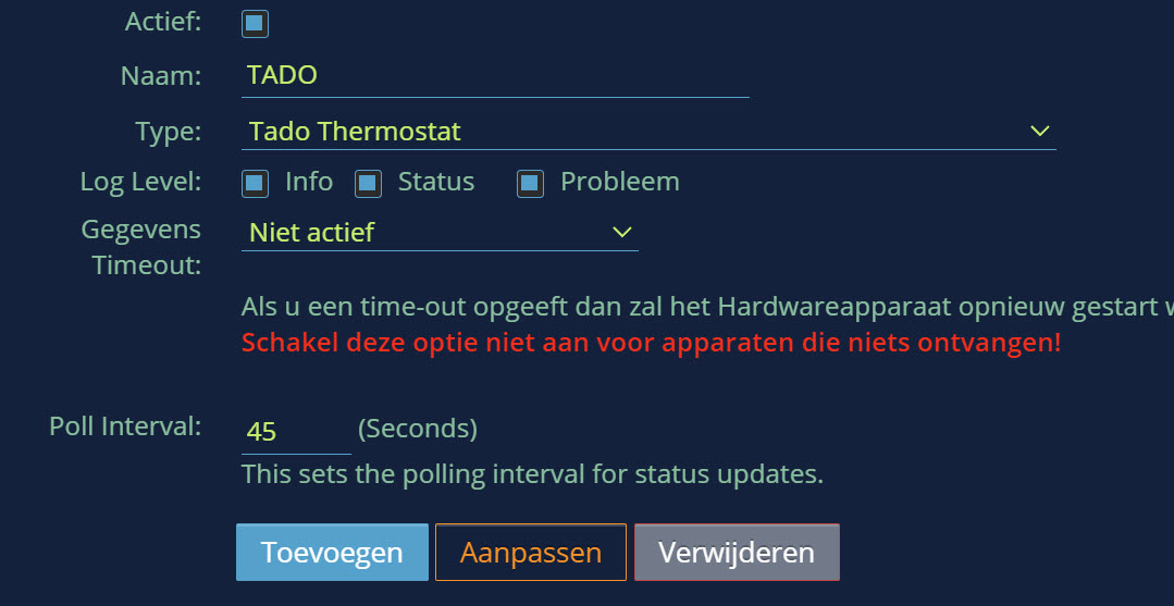

Just my thoughts:
I see this in the log : every 45 seconds I got 24 lines. I have 8 TADO devices. I assume that every devices counts for 1 poll.
Math:
    1440 minutes in a day x 60 secs = 86400 seconds total.
      8 devices = 8 polls.
        polling every 45 seconds
          total polls per day : 86400 /45 = 1920 * 8 devices = 15360 queries per day.
          If I set interval to 30 seconds, I will have to much polls = 23040
          So to set your polling interval, you should do the maths.

          I am afraid your math does not add up. Not sure how to compute the number of devices, but I have 10 radiators with a Tado knob. That gives me 19200 polls but after around 20hrs I am done. So most likely at least the bridge counts as 1 drives as well.
          I will test with 60 seconds. As far as I can see setpoint settings are immediatly handled.
          But first have to wait for around 2 hours before the counter resets

          In spite of the 60 seconds I set in the hardware tab, I notice the devices are updated every 30 seconds.
          Anyone know how this can be?

          Working as expected here : I did set the interval on 60 for testing. Also works as expected with 45 secs set.

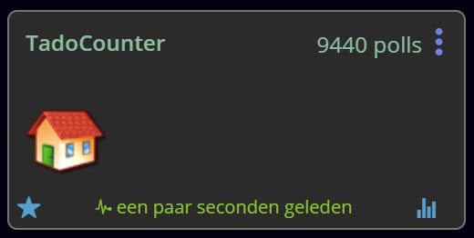

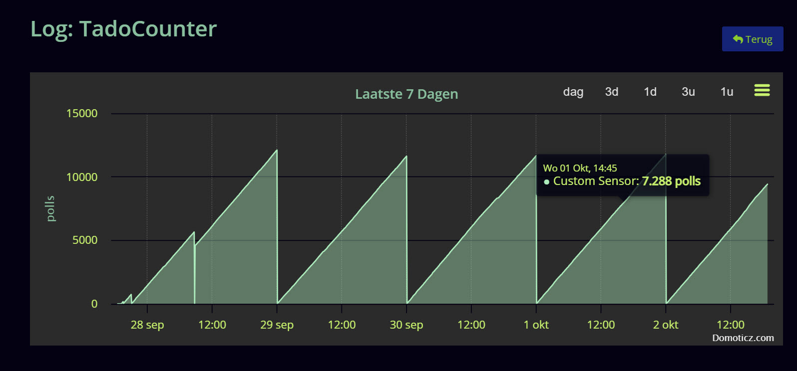

          I only see 3 items polled per device.
          I've made a script to keep track of queries, assuming that every device counts for one poll.
          This is working fine. And as far as I can see: it is correct... or it should be that my restrictions are not applied yet. TADO said that the limitations would be implemented within a certain period of time.
          I did test my daily polls with this script/counter.. altering the polling period to 30 seconds, gets me restricted again.
          Script:
          Just create a virtual counter, name it, adapt the script to reflect that name and alter the violation message to the first device that is mentioned in the log when polling.
          Also create a variable to hold the updated queries number.
          I do reset at midnight.

          **** end script ****
          Result:
          Kind regards,
          Sloeber70

          Thx, I will check when I count 3 polls for every device.
          The script is dzvents, which I do not use (and never will), I am a plain lua guy, propably because dzvents didn't exist when I started using Domoticz.
          But I guess U will make a lua/bash/python/perl script to do the same in the future ;-)

          Setting a new token (by disabling/enabling the Tado hardware) solves it temporarely. It looks like everything keeps working, but still I hate error messages.
          Anyone has clue?
          I am on build 2025.1(16787)
          Edit: can it be that the refreshtoken interval and the poll interval interfere?
          Edit2: looking at the tado.cpp it looks like there is a loop of 12 (MAXLOOPS) after which the token is refreshed. The loop is run every poll interval, when the poll interval is set to something > lets say 60 seconds, the token is gone before the refresh (I think). Since my c++ knowledge is not that high (to say the least), can someone alter this in the code?
          Edit3: Given the 600second token lifetime, the poll interval should never be greater than 600 and de maxloops should not be higher than the 600/pollinterval. Additional downside is the spoiled poll every 10 minutes or so.

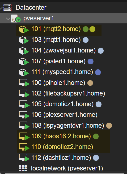

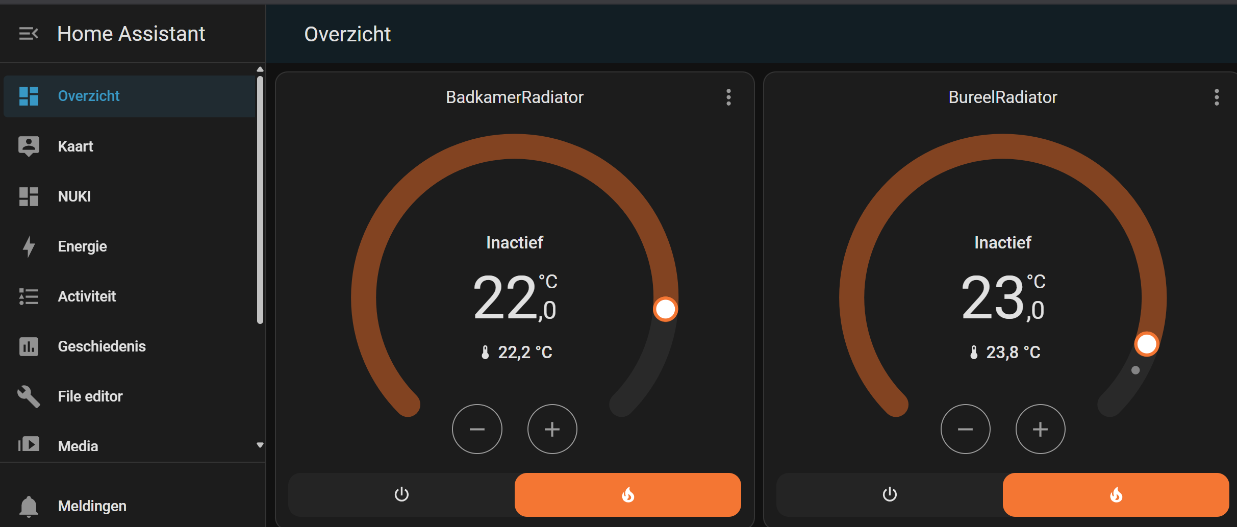

          I did setup a HA v16.2 stable VM on Proxmox and added the TADO plugin. I can monitor and control everything from HA.
          Created a dedicated MQTT LXC for testing

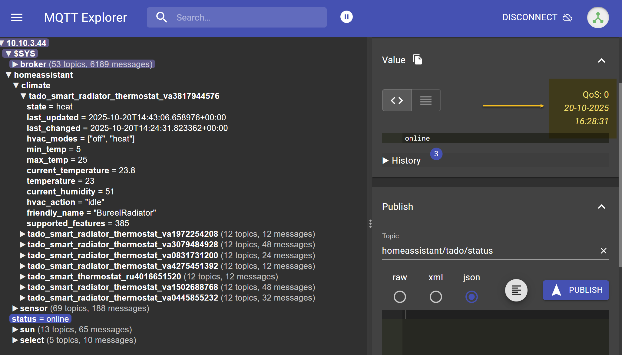

          HA sends the messages to MQTT LXC : no problems so far. Topics are updated normally. See MQTT explorer snapshot.

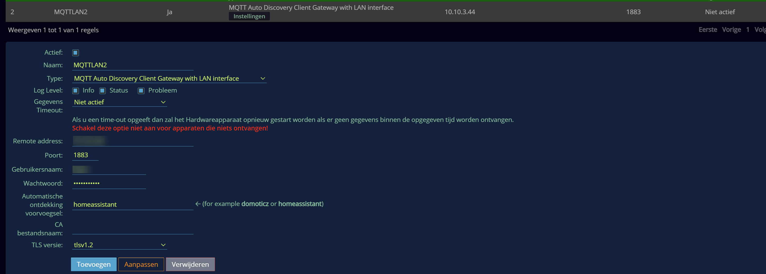

          But when trying to get results into Domoticz... nothing.. it fails... no errors in the log.
          2025-10-20 16:22:12.884 Status: MQTTLAN2: Connecting to 10.10.3.44:1883
          2025-10-20 16:22:13.085 Status: MQTTLAN2: Connected to: 10.10.3.44:1883
          New devices discovery is set on... no devices discovered...
          Did I miss something?
          HA Tado 2025-10-20_16-54-18.png (117.04 KiB) Viewed 5586 times
          domoticz mqtt2ad 2025-10-20_16-42-31.png (179.42 KiB) Viewed 5586 times
          MQTT explorer 2025-10-20_16-44-57.png (304.65 KiB) Viewed 5586 times

          HI,
          Could this be Domoticz MQTT-AD related?
          All topics are visible in MQTT Explorer but devices are not imported into DZ.
          I did setup a separate test environment on Proxmox VE:
          separate LXC MQTT broker
          separate VM domoticz - latest beta on Debian 13.
          The live environment is working fine on Proxmox....
