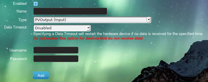

I would invest time to get it with that script into Domoticz or to implement MQTT. That saves the route via PVOutput.

So you are able to receive the production (via PVoutput) in Domoticz?I have been successful to pull the 5min timestamps from the EMA database into PVoutput, so I could load into Domoticz from PVoutput
The QS1 is probably not recognized by your Zigbee stick. It is the same with Zigbee2mqtt, but maybe it could be made.I do have a zigbee stick in my Synology server, but so far it does not see the inverters.

Then you do not need an extra Python script.
You said:
Can't you use the Domoticz "hardware". which is natively available in Domoticz.Yes, my data is uploading to PVO by a python script (apstopvoutput.py) in crontab every 5 minutes. Is there a python script available that sets up the domoticz sensors etc. on which I could build (basically merging both scripts)?
