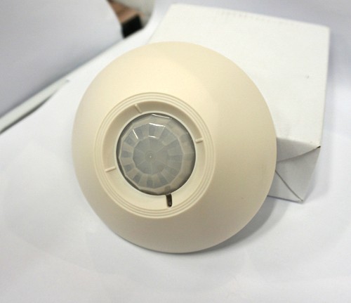

Does anyone know how i can use one of these cheap doorcontacts from Banggood to do this: http://td-er.nl/2014/05/12/bestaande-en-kaku-deurbel/
I opened the doorcontact, and mine uses a PT2264 chip. I looked up the [url=http://www.princeton.com.tw/Portals/0/P ... 2264_1.pdf]datasheet[/], and if pin 5 (TE, "Tranmission Enable") is connected to GND, it should transmit.
But nothing is happening....
The reedswitch is normally closed (NC). It breaks the circuit when the magnet is removed. Would be better if it would be normally open (NO), it would be easier to tap in with an optocoupler.
Edit: I think i will leave the doorcontact for now, and solve it by using one of these: http://www.ebay.com/itm/Electric-Clonin ... 1468459963
I already read that someone was using a remote like that with Domoticz (counting the flushes of a toilet, by connecting reedswitches to the buttons).
By the way, if i look at this: http://www.ebay.com/itm/Wireless-Ceilin ... 1365891287 there could be a chance that it would work. Components inside look the same as the PIR i already have. It also has 3M3 jumper, and code jumpers. 360 degree would be better to mount to the ceiling in my hallway or something. Only the price is a downside. Maybe someone else can find a cheaper one? Maybe i am not using the best search words.....
Edit2: Found a cheaper one: http://www.aliexpress.com/item/9V-batte ... 52701.html
That one will certainly work, i see the PT2264 chip, which is also in the PIR i now have, and that works with Domoticz
