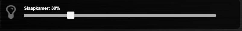

Does someone know how to remove the ": 30%" after a title
Naamloos 1.jpg (6.38 KiB) Viewed 5325 times

EdwinK
Posts: 1820
Location: Rhoon
Post by EdwinK »
Maybe by just renaming it
blocks[xx] = {};
blocks[xx]['title'] = 'Slaapkamer'';
where xx is your IDX?
htilburgs
Posts: 464
Post by htilburgs »
I found no way.... It's in the main.js (line 1040)
html+='<strong class="title">'+device['Name']+': '+device['Level']+'%'+'</strong>';
Maybe overrule with custom.js?

HansieNL
Posts: 994
Post by HansieNL »
htilburgs wrote:I found no way.... It's in the main.js (line 1040)
Maybe blocks[IDX]['level'] = false; is an option to add.
Just opened GitHub issue for this.

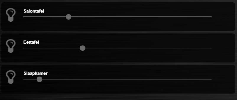

Trying to minimalize my sliders view.
Only the line of Salontafel is thicker than the rest. Maybe someone knows how to get it smaller or a better way to handle this?
Naamloos 4.jpg (16.41 KiB) Viewed 5223 times
.block_236 .ui-slider-handle,
.block_124 .ui-slider-handle,
.block_126 .ui-slider-handle {
    background-color: #6a6a6a;
    border-radius: 25px;
    border-color:  #6a6a6a;
    height: 15px;
    width: 15px;
.block_236 .ui-slider-horizontal,
.block_124 .ui-slider-horizontal,
.block_126 .ui-slider-horizontal {
    border-color: transparent;
    height: 1px;
Blah blah blah

Post by htilburgs »
I liked your idea, but with a little different buttons and moved the slider further down.
(And I don't have a problem with different thickness).
.block_46 .ui-slider-handle,
.block_70 .ui-slider-handle,
.block_179 .ui-slider-handle,
.block_193 .ui-slider-handle,
.block_213 .ui-slider-handle {
    height: 15px;
    width: 15px;
    padding: 6px 10px 6px 10px;
.block_46 .ui-slider-horizontal,
.block_70 .ui-slider-horizontal,
.block_179 .ui-slider-horizontal,
.block_193 .ui-slider-horizontal,
.block_213 .ui-slider-horizontal {
    height: 3px;
    bottom: -10px;
Hardware:
