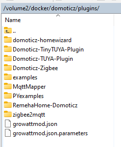

Thanks for your suggestions guys. Sorry for the NOOB questions but Linux is not my strongpoint and can not always make sense of folder structures. This is a synology NAS but should follow the same basics of Linux I presume.
my docker is installed in: VOLUME2/docker
in this folder I have these: download/file.php?mode=view&id=34320&si ... 1401be0bfb

So, I have no Userdata folder and still it works, exept for the remeha plugin offcourse. I presume /opt is the root of the docker container itself?
It worked when I installed the plugin somewhere in april or so. Ik have also some other stuff running like mqttmapper, homewizzard and some stuff I'm experimenting with but not all are active.

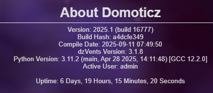

The 'about' page in Domoticz states python version 3.11.2
I have the volumes includes the way you wrote. It seems that every time when I update it breaks python within the container and now I can't even install python, when I do 'apt-get install python3.11' I get this:

root@domoticz:/opt/domoticz# python3 -V
Python 3.11.2

O, one thing. isn't it strange that for example the Grott plugin uses another version of Python? It shows 3.12.4 ? Where that version comes from?
root@grott:/app# python -V
Python 3.12.4
root@grott:/app# python3 -V
Python 3.12.4
root@domoticz:/opt/domoticz# python -V
bash: python: command not found
Python 3.11.2
I'm not really into linux so every time I run into issues I have to look over my notes and find out with help of google and forums. I don't use it often enough to let it stick.
I also finally did a domoticz update on the NAS of my brother in law who has the same ElgaAce and ran into the same issue. This time luckily it was easy with my above commands to get the plugin working again. Something must be wrong but If this works I can live with that.
I love to learn and get into docker more but in the end I know I don't use it regularly enough. But with all my tinkering I have a lot of things like MQTT, ZIgbee, Grott and Homewizard working on my NAS. Offcourse with the help of the community, places like this. I'm a happy camper
Thanks for all the remarks, it helps me thinking in all directions.
Python 3.12.4
Python 3.12.4
Python 3.11.2
