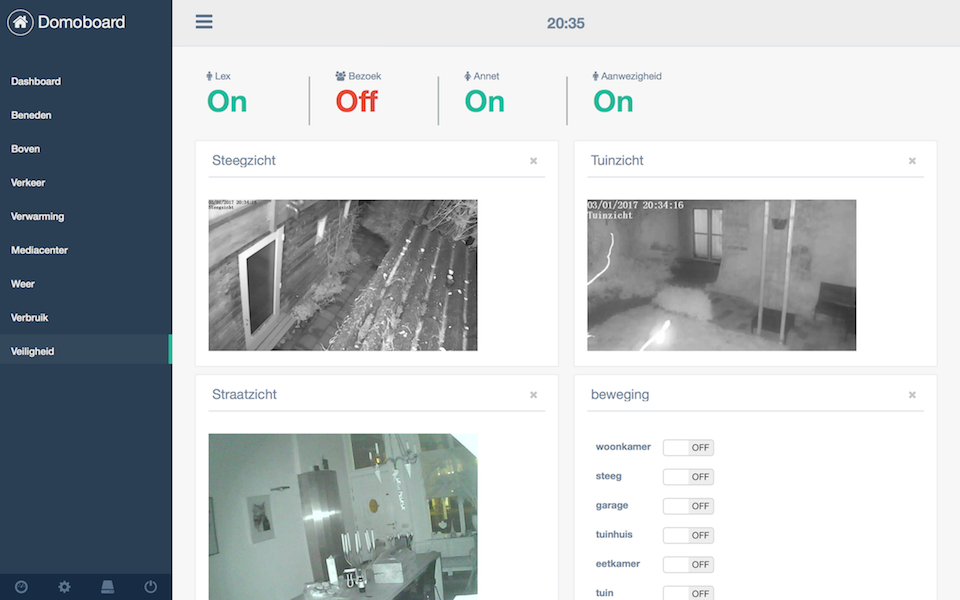

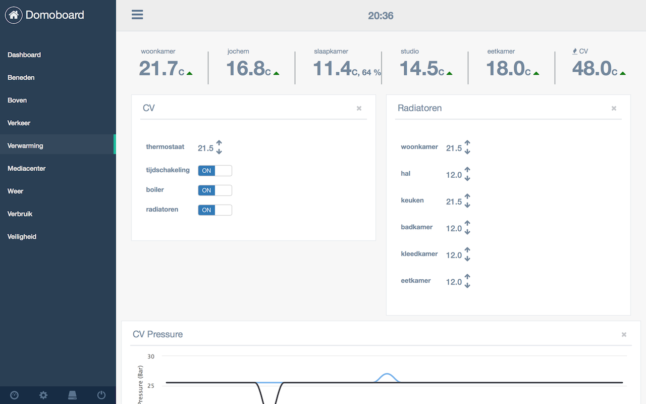

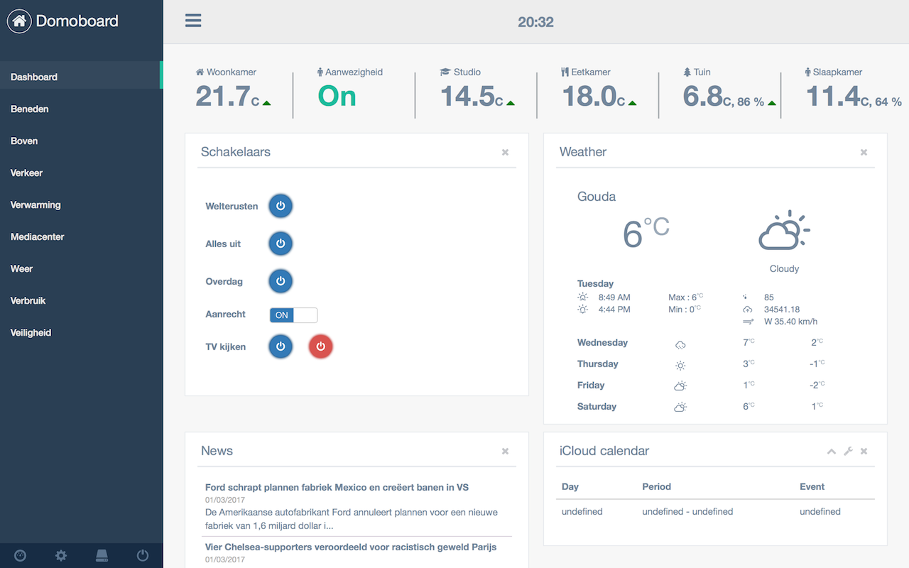

felix63
Posts: 244
Domoticz version: 2020.1
Location: Gouda
Re: Domoboard a New Dashboard using Domoticz as backend
Post by felix63 »
proza wrote:
I was wondering what kind off domoboards everbody are creating. Just some samples Image
Work in progress...

squandor
Posts: 213
Joined: Saturday 19 December 2015 22:34
Domoticz version: 3.5837
Post by squandor »
Nice Felix,
You're Dash looks awesome :) only bummer for the iCloud calendar? did you got any response from the iCloud plugin if you put an print to the for loop in iCloud.py ? :)
