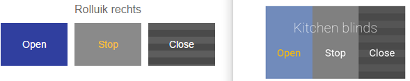

Just created a quick video which demonstrates a list of issues:
https://www.screencast.com/t/DDnNblIuqDQ
Note that for the blinds (Rolluik rechts) the buttons Open and Close don't work, but Stop DOES work
#mindblown
The dimmer also does work, but the yellow indicator doesn't move as nice as in the GitHub animation.
Lichtintensiteit:
Woonkamer (midden):
Kantoor:
Rolluik links (Offline):
Rolluik rechts:
Regards,
Rick

Anyway, just noticed there's a difference in design between my page and the GitHub screenshot.
Example: Is there any way to change to this new(?) design?

Actually the screenshot is from the old design. I had to change for 2 reasons:
1) contrast levels were too low, causing poor readability. The update in the color scheme is an attempt to (loosely) stick to WCAG standard recommendations on that. Universal design matters a lot to me.
2) Title was above buttons in other switch types such as selector switches.
One thing we could consider is removing the margin between open/stop/close. But the selector switch has margins so it wouldn't be very consistent.
Other than that, unless you build from an old version of the code, I am afraid you won't get the old style.
PS feel free to update these misleading screenshots in GitHub

Too bad. Actually liked the old design
Considering it's just another css file, any way of forcing the old design via url parameter or option?
