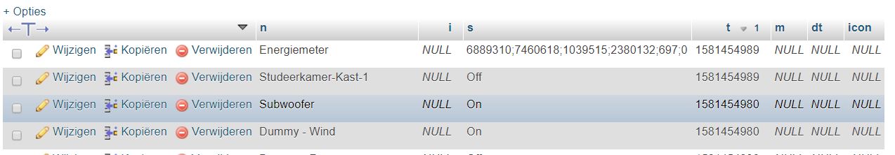

madradrakie
- Posts: 64
- Joined: Wednesday 11 September 2019 21:24
- Target OS: -
Re: Pass2PHP
SUPER! it is working. I think i have seen all 60 pages of this forum but did not found this solution. Thanks again for this part! Now lets start with the next stepMcMelloW wrote: Monday 10 February 2020 16:47I had the same kind of problem. See previous postings in this thread, the answers are very valuable and helpful.madradrakie wrote: Monday 10 February 2020 7:19 I have deleted that part of the code because i am not intend to use the floorplan. I placed all the necessary files at the location as prescribed and added the functions.php and config.php in the _fetchdomoticz file. I have no more errors anymore. Unfortunatley the database is not filled with the switches of domoticz when i trigger one in domoticz. Could this something to do with the fact that i use apache2 instead of nginx?
I think I put these lines at the top of _fetchdomoticz.phpAnd stripped config.php to this minimalCode: Select all
require '/var/www/config.php'; require '/var/www/html/secure/functions.php'; $db=new PDO("mysql:host=localhost;dbname=$dbname;",$dbuser,$dbpass);After this it did run without any errors. With PhpMyAdmin, I saw all active devises as a row in the Devices table. Correct me if I am wrong.Code: Select all
<?php /** * Pass2PHP * php version 7.3.4-2 * * Example config file * Can be placed in /var/www/config.php * * @category Home_Automation * @package Pass2PHP * @author Guy Verschuere <[email protected]> * @license GNU GPLv3 * @link https://egregius.be **/ error_reporting(E_ALL); ini_set("display_errors", "on"); date_default_timezone_set('Europe/Brussels'); if (!defined('TIME')) { define('TIME', $_SERVER['REQUEST_TIME']); } $log=false; $page=basename($_SERVER['PHP_SELF']); $dbname='domotica'; $dbuser='domotica'; $dbpass='domotica'; $domoticzurl='http://127.0.0.1:8080';

oke, still one more problem. My idx are not shown in the table. I tried to figure uit what @sincze did because he had the same problem but have not that many skills to figure it out.
- Egregius
- Posts: 2592
- Domoticz version: v2024.7
- Location: Beitem, BE
Re: Pass2PHP
Idx is only filled while running fetchdomoticz.
That script must also be executed every time you add/change devices in domoticz.

the following thing i did (already multiple times). I opened putty.Egregius wrote: Tuesday 11 February 2020 22:29 Idx is only filled while running fetchdomoticz.
Opened the secure map )(cd /var/.. and execeted php _fetchdomoticz.php. I get no errors.
Is this what you mean by execiting _fetchdomoticz.php?
When i look at the database the status of the devices is updated every time so that is not the problem.

madradrakie
- Posts: 64
- Target OS: -
Re: Pass2PHP
it is working. I had made a small error in the _fetchdomoticz file....Egregius wrote: Wednesday 12 February 2020 8:32 What is the output of the script?
I've made some small changes in it so the output in CLI mode would be nice.
The first simple php script is also working, lets continue explorering...next step... cron files..
