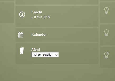

Post by SwordFish »
Ierlandfan wrote:For the afvalwijzer I modified the script which resides somewhere at the beginning of this topic. I will attach it later.
It's a LUA script that changes the level based on the (manually inserted) dates. So if you change the dates to your needs it's the same idea.
It also tells you paper and trash for example.
Works like a charm! I need to find myself (or create) some fancy colored bins.
Edit:
Out of the top of my head.
Put the attached file in the domoticz/scripts/lua folder.
Change script.xxx.txt to script.xxx.lua (sudo mv script.xxxx.txt script.xxx.lua)
Create a selector switch in Domoticz and change IDX104 in your IDX.
Create the levels (Domoticz page>Switches>click on edit in the selector switch. Dont forget clicking "add" after each level.
Find yourself a trashcalender and change the weeknumbers according to the trashbin (and/or) paper weeks.
I changed your script a little to my needs 8-)
