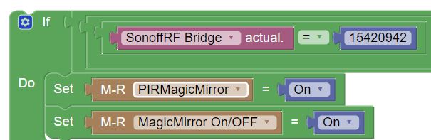

i was looking for a way to improve the handling speed of my sonoff pirs and found this topic. I have found the installation guide and have some basic skills so would like to give it a try. Before i start i have a question. My pirs are connected through the sonoff rf bridge. The pirs sends a 433mhz signal to the sonoff bridge. The sonof bridge decodes this signal in a MQTT messages which domoticz receives. When domoticz receives the messages a light is switched with a blocky script. This last part i want to replace by the pass2php script to improve the handling speed.
The MQTT messages looks like this:
2020-02-08 13:36:26.140 MQTT: Topic: domoticz/in, Message: {"idx":982,"nvalue":0,"svalue":"15420942","Battery":200,"RSSI":6}
The blocky scripts look like this:
Is this also possible with one of the php scripts?
Thanks in advance.
