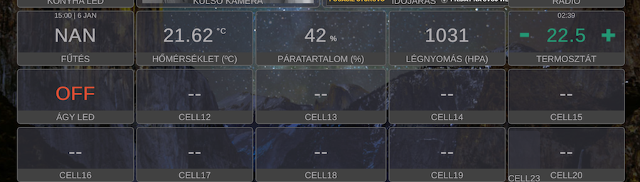

Guys, one question:
I can't get to work one Dummy switch. I have few of them, but this one is not working. It's just showing "Nan" and doesn't reagate to click.
 "AddjMulti" : 1.0,
         "AddjMulti2" : 1.0,
         "AddjValue" : 0.0,
         "AddjValue2" : 0.0,
         "BatteryLevel" : 255,
         "CustomImage" : 15,
         "Data" : "On",
         "Description" : "",
         "Favorite" : 1,
         "HardwareID" : 2,
         "HardwareName" : "Dummy",
         "HardwareType" : "Dummy (Does nothing, use for virtual switches only)",
         "HardwareTypeVal" : 15,
         "HaveDimmer" : true,
         "HaveGroupCmd" : true,
         "HaveTimeout" : false,
         "ID" : "00014060",
         "Image" : "Heating",
         "IsSubDevice" : false,
         "LastUpdate" : "2017-01-06 15:00:01",
         "Level" : 100,
         "LevelInt" : 100,
         "MaxDimLevel" : 100,
         "Name" : "Heating",
         "Notifications" : "false",
         "PlanID" : "4",
         "PlanIDs" : [ 4 ],
         "Protected" : false,
         "ShowNotifications" : true,
         "SignalLevel" : "-",
         "Status" : "On",
         "StrParam1" : "",
         "StrParam2" : "",
         "SubType" : "Switch",
         "SwitchType" : "On/Off",
         "SwitchTypeVal" : 0,
         "Timers" : "true",
         "Type" : "Light/Switch",
         "TypeImg" : "lightbulb",
         "Unit" : 1,
         "Used" : 1,
         "UsedByCamera" : false,
         "XOffset" : "0",
         "YOffset" : "0",
         "idx" : "17"
Screen Shot 2017-01-07 at 02.45.29.png (35.64 KiB) Viewed 3994 times
Screen Shot 2017-01-07 at 03.58.04.png (337.49 KiB) Viewed 3988 times
.js:
['17',	'Status',		'cell6',	'Heating','0','0'],
If I turn on "lastseen is wanted" -> I can see the correct date.
What's wrong with this?

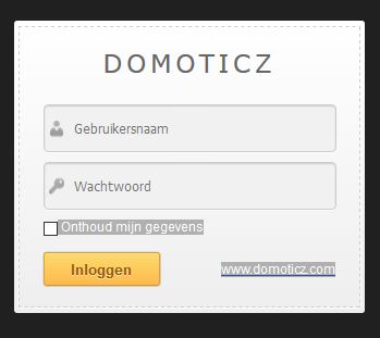

Is ther anyone that can tel how to change mij inlogscreen? I just want to change the Domoticz into my name.
Inlog screen
Inlog screen

Post by ropske »
hi ChrisPi,
i don't think you can change this, unless you change it in the sourcecode and rebuild it

I created similar dummy switch and replaced the not working switch with this. Now it works. Anyone knows what happened here?
