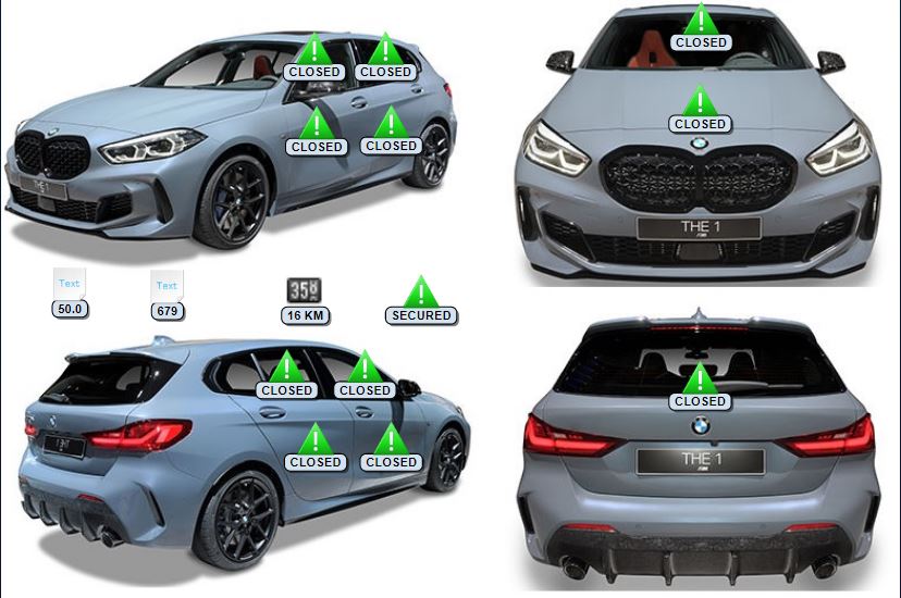

Just started with a new project in Pass2PHP.
In addition I can also get the vehicle location. I guess it should be quite easy to extend the Pass2PHP Database with a few more columns? Or would a separate DB be a better idea? Maybe I can extract the data later and plot... my driven maps ?? ;-)
My first steps at @Egregius floorplans ... :lol:
Please submit your suggestions.

I think the current database can do. Every door/window as separate device. Maybe use status and mode for the coordinates?
Once you’ve found your way in the floorplan you won’t want anything else :D

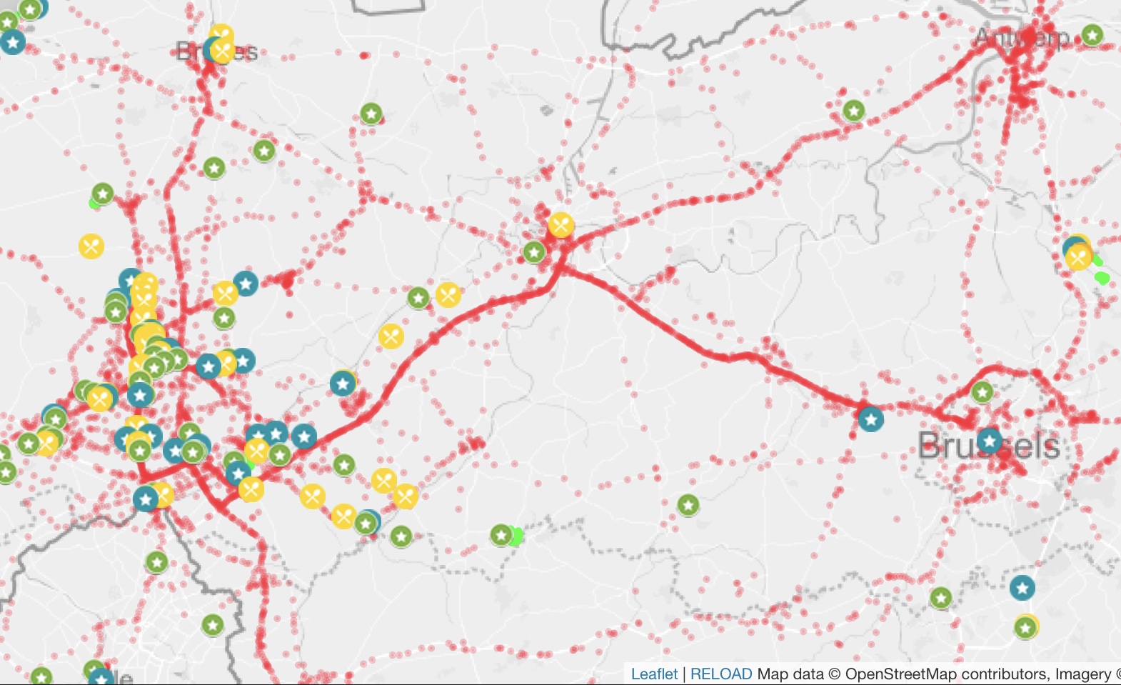

What do you want to do with the coordinates?
Google ‘leaflet’, I use that to combine Google Mymaps, Google location history and Gurumaps tracks.

The idea, draw some daily picture about where the car was, or where it is now.
As not all famlily members will have the BMW app installed. :D
Current location can be plotted easily with Telegram (bot) and Google Maps for free.
Excellent suggestion indeed: https://www.endpoint.com/blog/2019/03/2 ... ps-leaflet

I only want to see a combined history of places where I've been. Therefor in my MySQL table for the Google Location history I only have lat, lon as columns with a primary key on both. Without a timestamp or any other information. Each location that I receive is rounded to about 30 meters to avoid lot's of points.
For your case I would suggest a separate table and some functions to store and retrieve the data.
