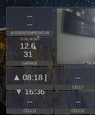

JuanUil wrote:Hi there all,
I have a Foscam FI9900P camera and I am still not able to get the stream in this frontpage.
I have this code in my frontpage.html:
<div id="frame">
	<div id="ls_cell3"></div>
	<div id="cell3"><img src="http://192.168.1.133:88/cgi-bin/CGIStream.cgi?cmd=snappicture&usr=User&pwd=Password"  onClick="lightbox_open('camera', 25400);" width="200px" class="camera" /></div>
	<!--  <div id="cell3"><img src="" onClick="lightbox_open('camera', 25400);" width="200px" class="camera" /></div> -->
	<div id="bcell3"></div>
	<div id="desc_cell3">Camera achter</div>
</div>
but I stil get webcam offline.
anybody any idea what I am doing wrong?
tnx for any help
Jan
After a deep dig into my memory, ran into it myself. At the end of the frontpage.html there's another section which also controls a bit of the webcam cells.
My advice is test it first with a static image (you put it there first) in the domoticz www folder/directory and call that with the url http://domoticz.ip.add.ess:port/imagefilename.jpg
And use one of the other camera names first eg camera2 or camera3. These names need to be the same also.
G3rard

G3rard wrote: Change IP and port to your Domoticz settings and the idx=5 to the camera idx you are using.
Sorry G3rard... I have a cam on cell3 that it's work using the domoticz idx 1 ... but only the jpeg it's work.
If I click on it I take an error:
2016-12-29 08:18:10.511 frontpage.html:93 Uncaught SyntaxError: Invalid or unexpected token
The code I have is:
on frontpage.html:
<div id="cell3"><img src="http://192.168.1.96:8080/camsnapshot.jpg?idx=1&t=" width="200px" class='camera'  /></div>
<div id="popup_camera"><img src="http://casuta.me/camsnapshot.jpg?idx=1&t=" onClick="lightbox_close('camera');" width="640" height="480" onload='setTimeout(function() {src = src.substring(0, (src.lastIndexOf("t=")+2))+(new Date()).getTime()}, 100)' onerror='setTimeout(function() {src = src.substring(0, (src.lastIndexOf("t=")+2))+(new Date()).getTime()}, 1000)' class='bigcamera' /></div>
on js/frontpage_settings.js
['0','Data',            'cell3',        'Camera garage','0','0'],
Can you please help me
Thanks in advance
Denis
The code I have is:
on frontpage.html:
Thanks in advance
Denis
Check the javascript code... sometimes copy/paste doesn't work, including 'hidden' formatting or other code.
Also check the url.
Syntax means simply said theres a call which isn't correctly formed. Missing closing single qoute, double quote, round or square hooks.

JuanUil
Posts: 500
Joined: Friday 22 May 2015 12:21
Domoticz version: 4.11083
Location: Asten NB Nederland
Post by JuanUil »
Hi all helpers,
I think I am getting crazy.
I have my camera working now but the pop-up of thed camera is constantly at the bottom of my screen.
This is the code I am using in frontpage.html:
<div id="frame">
	<div id="cell3"><img src="http://192.168.1.133:88/cgi-bin/CGIProxy.fcgi?cmd=snapPicture2&usr=Username&pwd=Password&t=" onClick="lightbox_open('camera1, 25400);" width="200px" class='camera' " /></div>
	<div id="desc_cell3">Camera kamer</div>
</div>
and at the bottom:
<!-- Popups under -->
<div id="popup_protected"></div>
<div id="popup_switch"></div>
<div id="popup_camera1"><img src="http://192.168.1.133:88/cgi-bin/CGIProxy.fcgi?cmd=snapPicture2&usr=Username&pwd=Password&t=" onClick="lightbox_close('camera');" width="640" height="480" onload='setTimeout(function() {src = src.substring(0, (src.lastIndexOf("t=")+2))+(new Date()).getTime()}, 100)' onerror='setTimeout(function() {src = src.substring(0, (src.lastIndexOf("t=")+2))+(new Date()).getTime()}, 1000)' class='bigcamera' " /></div>
<div id="popup_camera2"><img src="http://api.buienradar.nl/image/1.0/RadarMapNL?w=640&h=480"  onClick="lightbox_close('camera2');" class="" /></div>
<div id="fade"></div>
Buienradar is working well but my camera not.
What am I doing wrong?
Jan

JuanUil wrote: <div id="popup_camera1"><img src="http://192.168.1.133:88/cgi-bin/CGIProx ... assword&t=" onClick="lightbox_close('camera');" width="640" height="480" onload='setTimeout(function() {src = src.substring(0, (src.lastIndexOf("t=")+2))+(new Date()).getTime()}, 100)' onerror='setTimeout(function() {src = src.substring(0, (src.lastIndexOf("t=")+2))+(new Date()).getTime()}, 1000)' class='bigcamera' " /></div>
If I can help you, it's like it not take well the bigcamera class
Take a look with chrome debug mode and control if the bigcamera class is charge.
Denis
denisj
Posts: 58
Joined: Saturday 17 December 2016 13:13
Post by denisj »
Try to take out the double quote here:
Denis
Denis
took out the doublequote and bigcamera class is working.
I have added
onClick="lightbox_close('camera1')
and now I can close the pop-up
but clicking on cell 3 doesn't open it again
pop-up is also in the wrong place
denisj
Posts: 58
Post by denisj »
I think is better if you take a look at the original frontend file here:
https://github.com/gerard33/frontpage/b ... tpage.html
And the control your strings of "camera" ...see if there is some difference.
Denis
JuanUil
Posts: 500
Post by JuanUil »
That did the trick!!@
It's working perfectly now!
Thank you all for the help!
Jan
