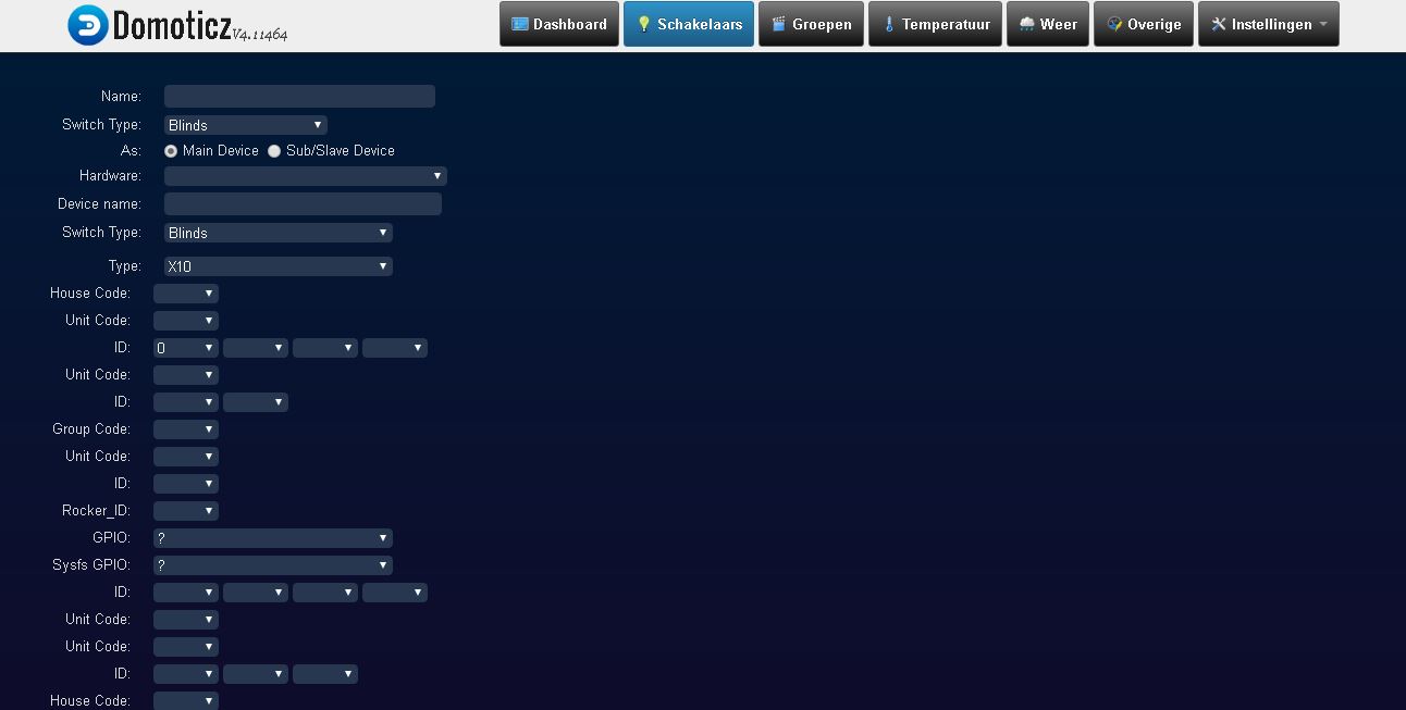

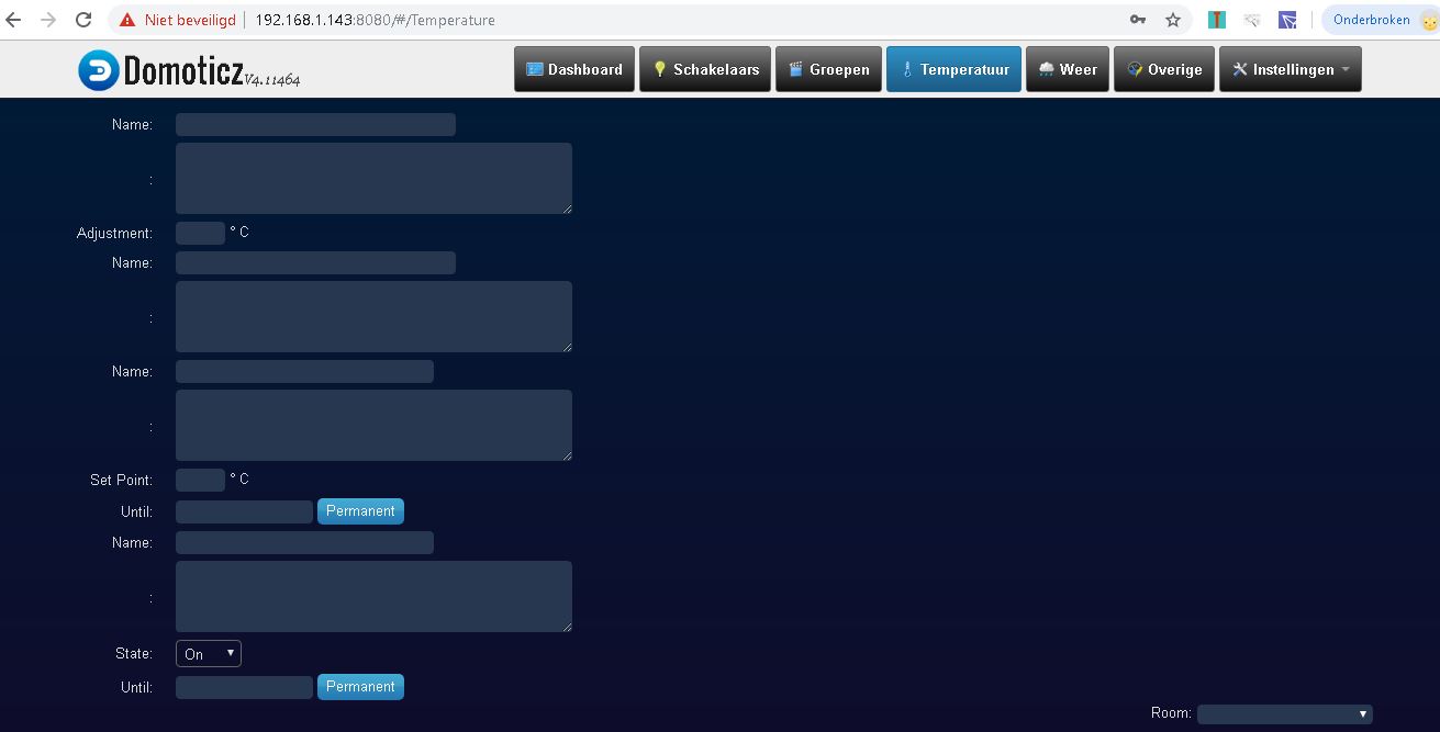

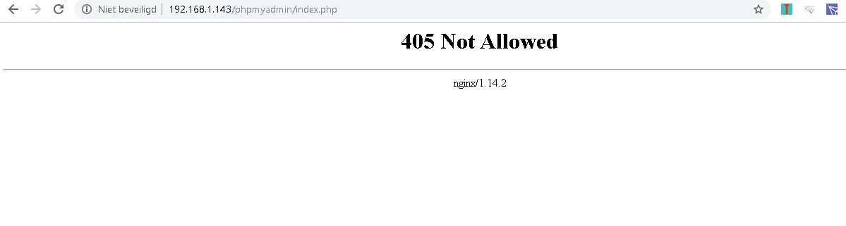

suddenly my domoticz is not working fine anymore, when i want to goto temperatures or Switches tabpage, i get this:
if i want to go to myphpadmin page i get this:
please help, i'm outside the country for work and my wife is stuck with the system, she cant put on the heater,...
thanks

Trigun wrote: Monday 04 November 2019 18:42 Why not pull the plug and restart it?
Did you carry out any updates?
i already tried to reboot it, but the problems stays
ropske
Posts: 483
Domoticz version: V3_8394
Location: Rumbeke,Belgium
Re: Pass2PHP
Post by ropske »
ok, update:
after doing this again:
GRANT ALL PRIVILEGES ON *.* TO 'domotica'@'localhost' IDENTIFIED BY 'domotica';
i can access my phpmyadmin page again and pass2php is running again (i can see in the debug logging i activated)
Now, i still don't get a working dashboard/switches and temperatures tabpage in Domoticz.
I'm just wondering why/how it comes this suddenly happened??
ropske
Posts: 483
Re: Pass2PHP
Post by ropske »
and when i want to open other php files for example /secure/domoticz_devices.php
it is downloading the php file instead of opening it
running /secure/phpinfo.php is working well then
realy strange things
