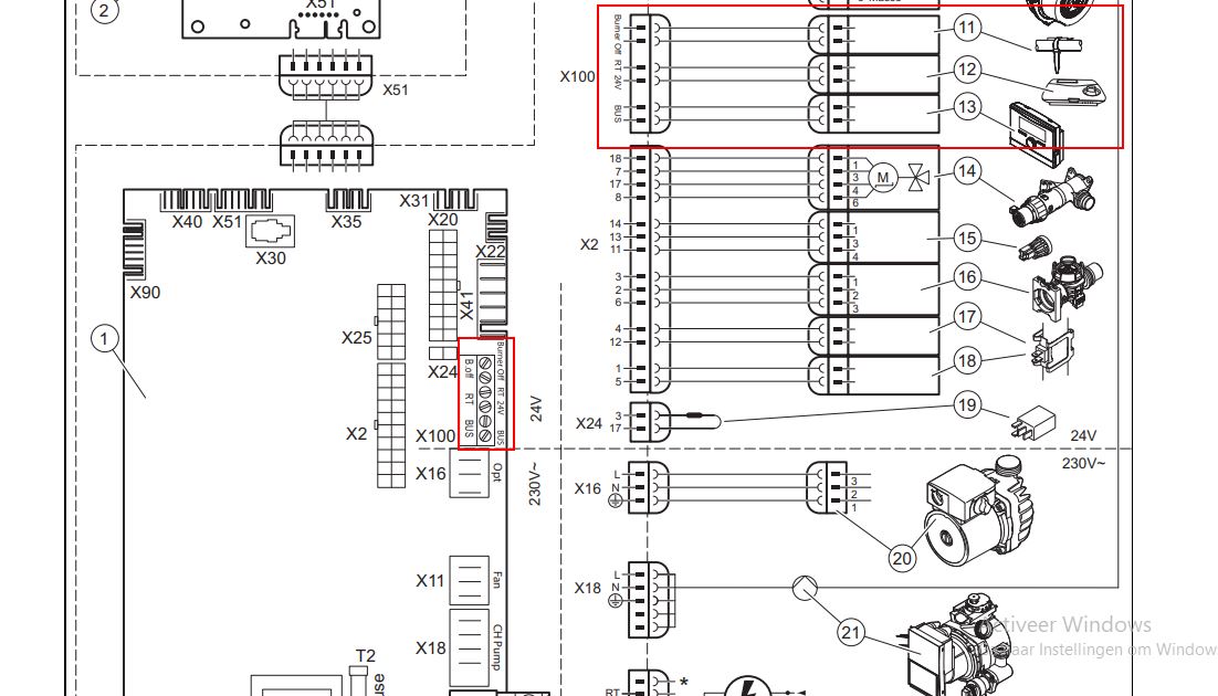

this is the layout of the printboard of my Vaillant heater:

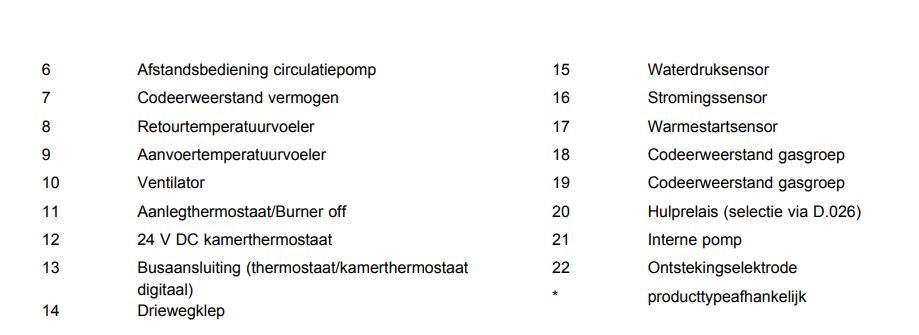

and the functions:
i was using before a Fibaro Double Relay FGS-222
but then i connected the thermostat between IN and Q1, and IN was connected to my L(230V)
But i cant connect my IN anymore to my 230V because the contact on the printboard of the heater now is only 24VDC
Or i just need to connect the RT24V (printboard burner) to IN and Q1 of my Fibaro relay?
and L & N of the Fibaro module to the normal 230VAC ?
Egregius
Posts: 2592
Domoticz version: v2024.7
Location: Beitem, BE
Re: Pass2PHP
Post by Egregius »
Definitely IN and Q1 (without connection to L) to have a potential free relay.
I'm just not sure wether you should connect it to 11 or 12.
I would go for 12. And if it doesn't work as desired 11.
My Bosch burner has the same kind of connection. 13 is a bus where a 'smart' (read stupid) thermostat is connected. At 12 there was a bridge installed. When I removed that the burner stopped and I knew I could connect my relay there.
Egregius
Posts: 2592
Re: Pass2PHP
Post by Egregius »
After viewing https://www.vaillant.be/downloads/foutc ... 720578.pdf I'm pretty sure you can safely connect to 12 RT 24v.

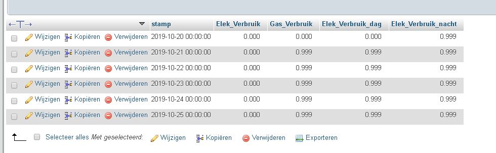

i want to save my electricity and gas usage to mysql database.
but the data inside is allways 0.999 (in mysql database)

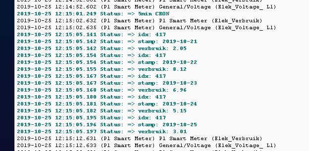

the values i'm getting are good:

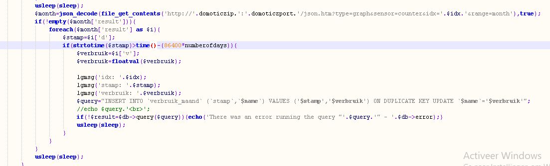

this is my code:
Egregius
Posts: 2592
Re: Pass2PHP
Post by Egregius »
What is the structure of your table?
You can also combine your lgmsg into one:
lgmsg('idx: '.$idx.'	stamp: '.$stamp.'	verbruik: '.$verbruik);

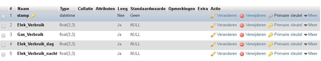

Post by ropske »
here it is:
Egregius
Posts: 2592
Re: Pass2PHP
Post by Egregius »
Change the columns to float 5,3.
Now you have 3,3 wich means a total number of 3 with 3 digits after the decimal. Therefor the value can never be more than 1 and gets truncated.
