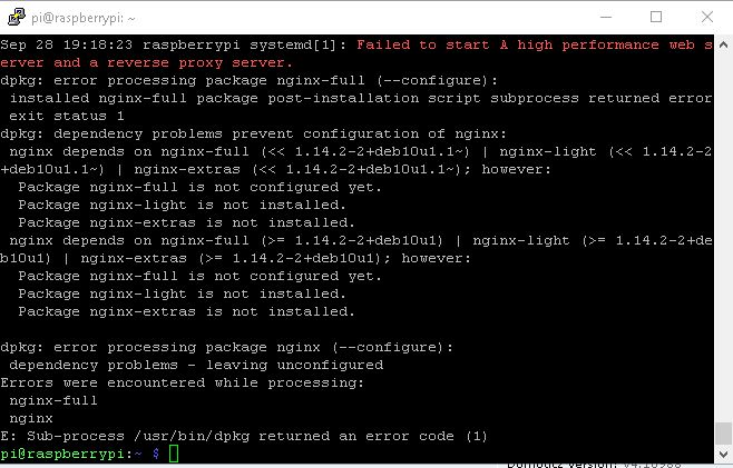

with what type of OS you installed these Sincze?
I have now a Raspberry Pi3b+ with image: 2019-07-10-raspbian-buster-lite
And when i'm doing the sudo apt-get install xxx what you said, I'm getting these errors:
- 1.jpg (73.6 KiB) Viewed 1696 times

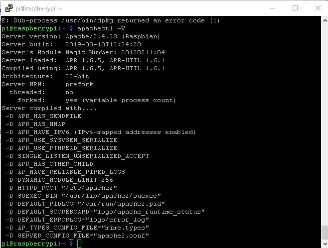

Please check if Apache is running. Depending on the command Apache might also be installed and will get in the way of Nginx to workropske wrote:with what type of OS you installed these Sincze?

i got this in response, so i guess it is running?
I need to remove it / disable it?
And then start again with the 'installation guide' from Sincze?

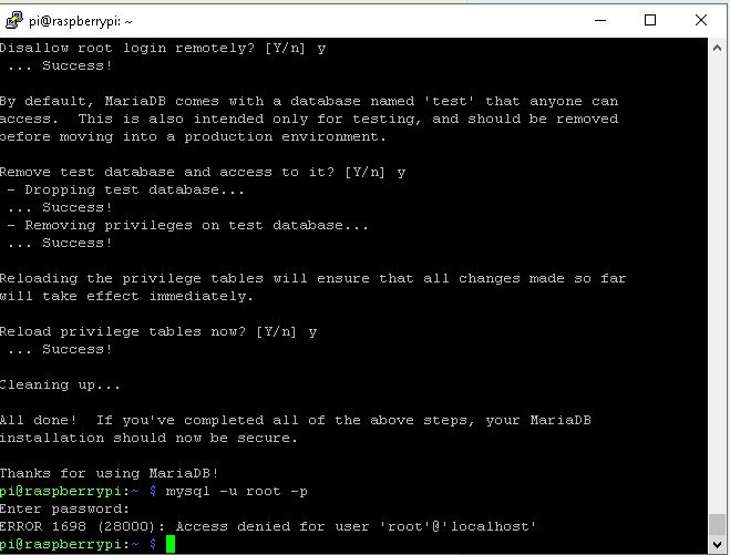

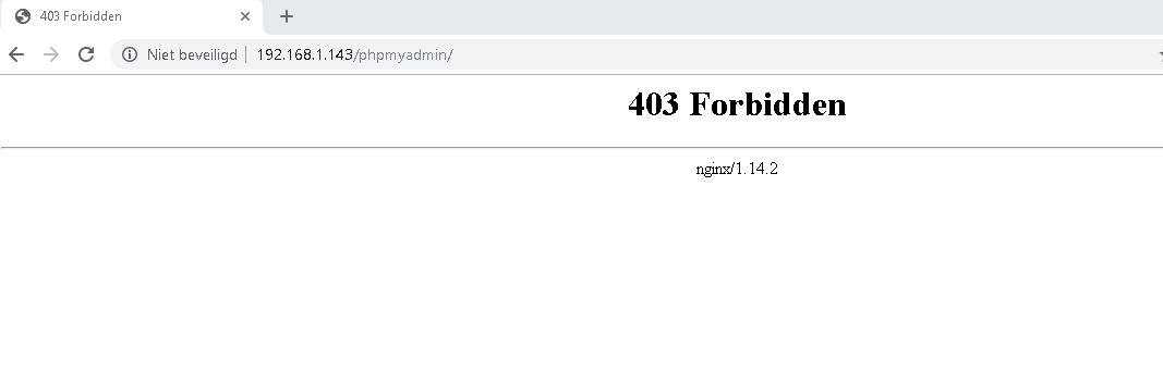

and i'm getting this when i'm enter command: mysql -u root -p
i stopped the apache service by doing this command: sudo service apache2 stop
and when i want to go to phpmyadmin page it says forbidden:
- 4.jpg (18.74 KiB) Viewed 1690 times
Trigun
- Posts: 390
- Joined: Wednesday 30 November 2016 11:58
- Domoticz version: 4.10717
Re: Pass2PHP
Hi Robske,
See the file attached for a how to.
It took me a few times to get it right but I after getting it wrong all the time, I started to make a how to with all the info and help from the guys in this forum.
Hope you'll manage to get it working!

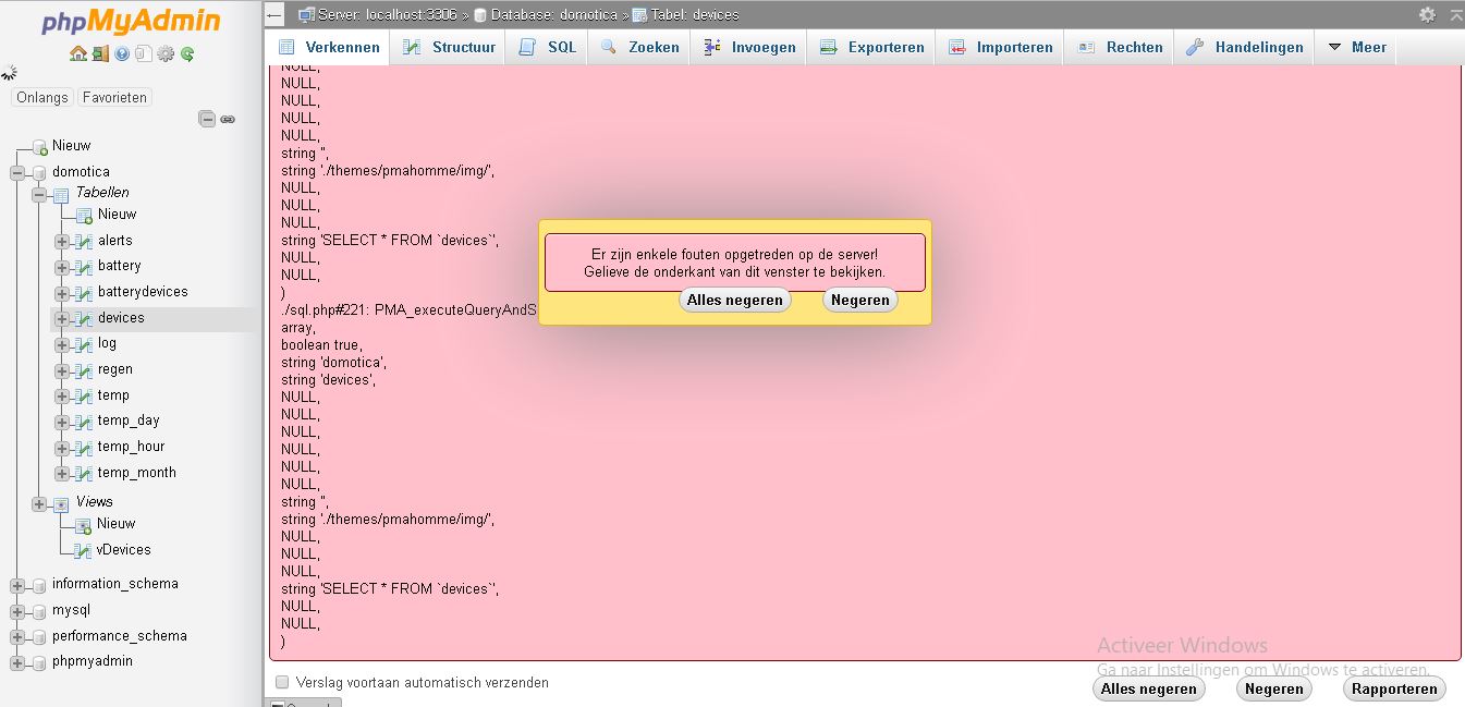

i managed to install the database and all
when i want to check the values in devices, i get this error message: when i click: ignore all, i can see my values

Great, good to hear!ropske wrote: Sunday 29 September 2019 20:53 thanks mate
Do you have spaces or other unnormal characters in your devicesnames?

some underscores _
but for the rest i don't have strange characters
btw, i got these errors when i click on every column, even the ones that are standard in phpmyadmin

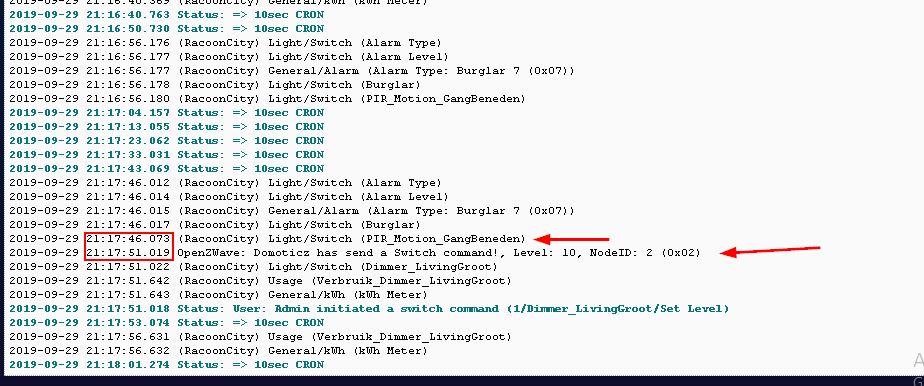

i installed a motion sensor now, and i see its taking some time to switch on my lights in screenshot above its 4seconds, but i happened allready it was +-7seconds
this is what is in my motion.php

The how to also shows some optimizations so really check it as it will definitely help.ropske wrote:ok, i will check.

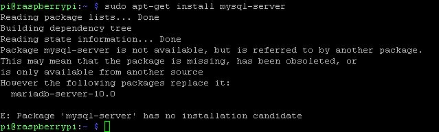

when i want to install this:
Install MySQLserver
sudo apt-get install mysql-server
i get this error message: may i do:
sudo apt-get install mariadb-server-10.0
is there anything else that changes then?
thanks
