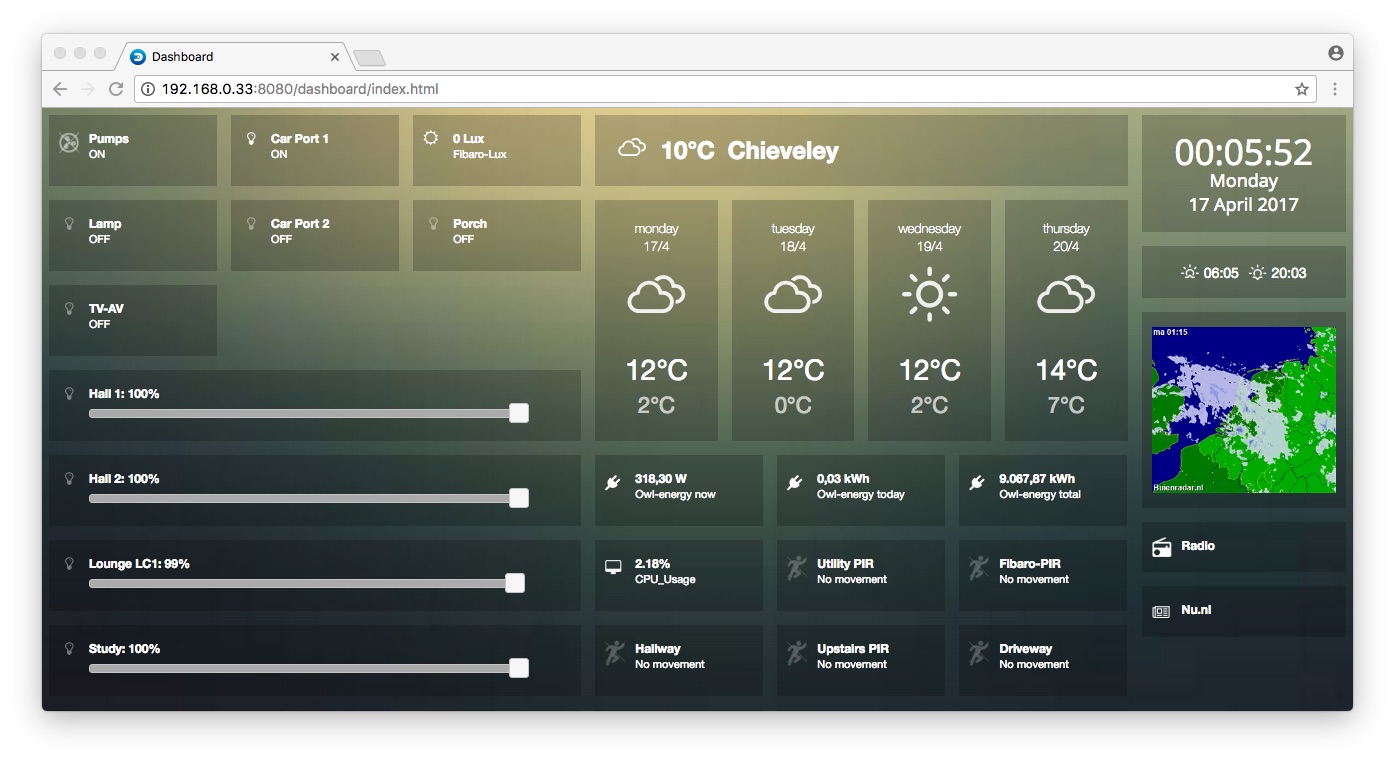

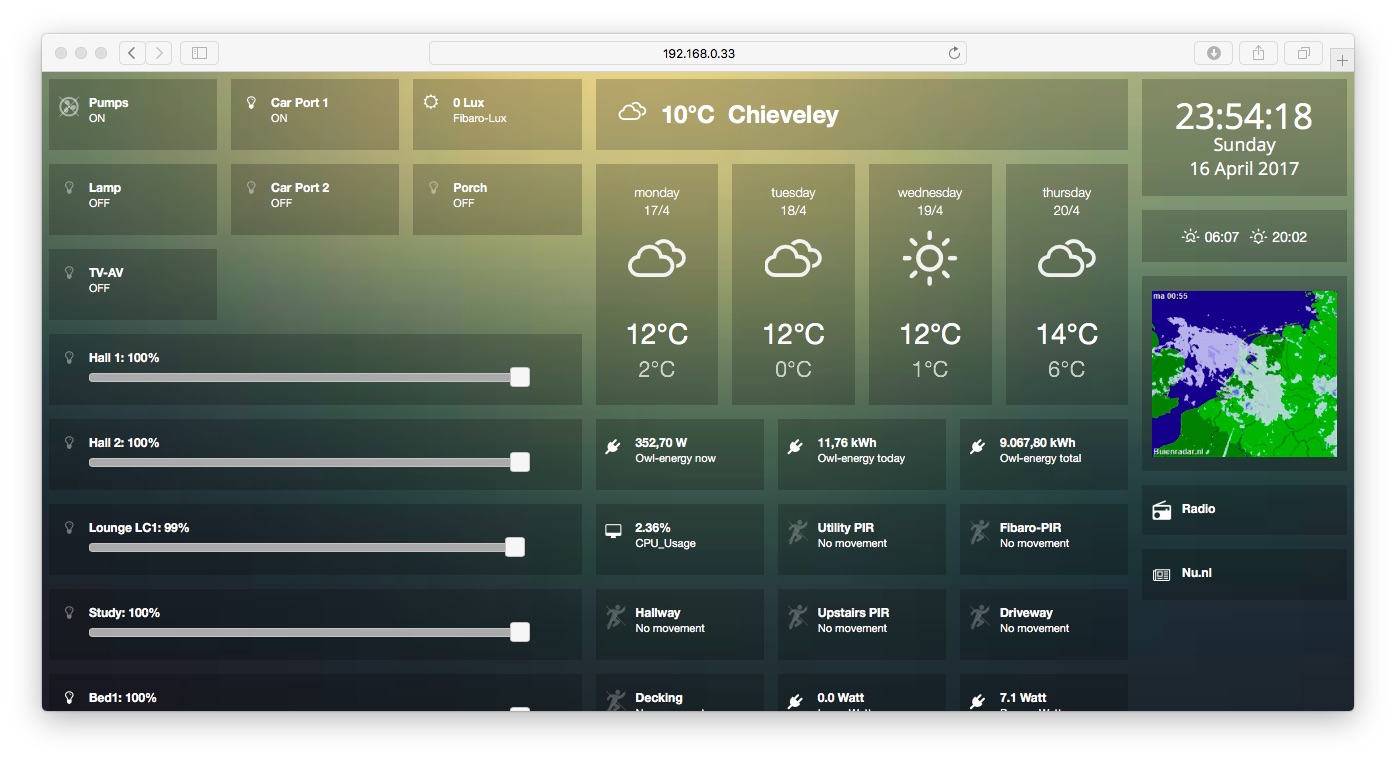

Couple of minor observations when using auto layout.
1. Safari and Chrome on my 2011 MacBook air 11" behave differently when window is not maximised but is using full height of screen above the dock - in Safari you lose the bottom of the dashboard like this:
Where as in Chrome it works well:
2. The Pumps icon (fan) appears greyed and crossed out even though it is ON

whiteduck wrote:Hi Rob
Well, this is normal behaviour, you see a bit of the 5th slider in safar because the bar on top of the browser is less heigh dan Chrome's bar...
whiteduck wrote: 2. The Pumps icon (fan) appears greyed and crossed out even though it is ON
Whats the output from Domoticz of Pumps?

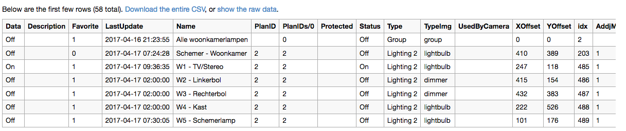

Is there a way to get a list of all the used idx numbers in Domoticz (export to excel).
That's a lot easier than clicking around in the Devices list and write the numbers on a piece of paper

gjaa wrote:Is there a way to get a list of all the used idx numbers in Domoticz (export to excel).
If you use the following URL, you get all the USED devices and can save this to a text file for later use.
[url]http://ipadress:port/json.htm?type=devices&displayhidden=1&displaydisabled=1&filter=all&used=true[/url]
+use this and you are good to go:
https://konklone.io/json/

madrian wrote:
Yeah this is amazing
Schermafbeelding 2017-04-17 om 11.28.27.png (84.68 KiB) Viewed 2983 times
Thanks, this was what I'm looking for
