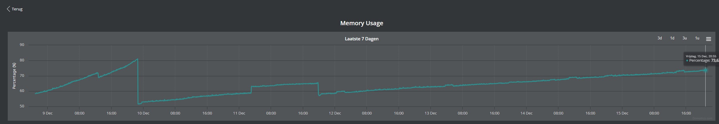

rensbr wrote: Thursday 30 November 2023 9:48 <snip>
After the last installation of Tuesday I'm running into memory leak problems, is that something you recognize from the beta plugin?
Within out 6 to 8 hours the whole memory runs full, then Domoticz does 'something', I have no idea what that is, since everything is unresponsive when the memory is full. The memory is cleaned up then and it will run full again over time. Here you can see the log of the memory:
I'm not sure if this has anything to do with your plugin, but I have no idea how I can look into the docker container to look for the separate RAM usages.
I have done some more testing but the outcome did not really narrow it down :(
With or without the iDetect plugin enabled the docker container running Domoticz would show an increase in memory use of around 1MB per minute. iDetect was monitoring a FritzBox, so no SSH. When I also enabled (a second) iDectect that was using SSH the memory increased a bit quicker. Might be the ssh, the additional Domoticz 'hardware' of the addition python plugin. That still needs te be tested, but I don't have the time this week.
Also wrote a little testprogram using the exact same SSH approach as the plugin and left it running for a few hours and a poll interval of 5 seconds. It showed no noticeable memory increase.

EscApe wrote: Wednesday 13 December 2023 7:42
I have changed the plugin back to the original and I'm coming up with the same conclusion. The memory still runs up, see below:
Schermafbeelding 2023-12-15 205759.jpg (78.25 KiB) Viewed 10062 times

There seems to be a memory leak issue in the plug-in framework that might have been fixed by a recent commit. I don’t know if it is related, but it’s worth trying the latest Domoticz beta.
I will try it myself, but not right now.

If you want to help figure out why parallel-ssh is causing a memory leak when used in my Domoticz plugin then you can re-enable it by copying ssh_tracker.py.use-pssh.py over ssh_tracker.py in the trackers directory.
Unrelated but good news: Plugins like iDetect can be restarted again in Domoticz 2024.1 :D Thanks to the Domoticz developer that fixed the framework!
What is the difference now between your beta plug-in and the normal one?
And what is you experience with the memory leak in the 2024 version?
The beta uses the extended (DomoticzEx) framework.The previous version uses the legacy framework, which is limited by the maximum number of units (255).
The beta version only loads python modules that are required by the trackers that are actually in use, while the previous version will try and load every module for every kind of tracker (and displays a warning message for the ones that are missing).
I have not measured the exact difference between 2024.1 and the 2023 Domoticz version, but both show a (slight) increase in memory usage on an otherwise empty Domoticz setup in a docker container. Even with an empty plugin (not iDetect). The memory leak when using parallel-ssh was horrible. In a test setup that would poll every 3 seconds(!) I would see a 0,5MB/minute rise in memory usage when using parallel-ssh . The same setup using paramiko showed 0.02MB/minute. A completely empty python plugin would still show 0.01MB/minute, so I don't think there is much more I can do about it. Memory leaking in the python plugin framework seems te be an ongoing discussion.
Maybe other python or Domoticz versions can improve the situation.
Thanks for the conqinues support you are giving. I have updated Domoticz to the latest version now. The plugin is still the 'original' one. Let's wait and see how that works for now.
