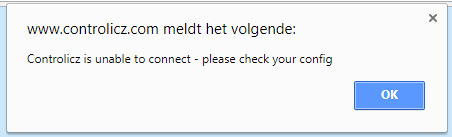

When I press the "Test Domoticz" button, it states it is unable to connect, but when I go to the URL and port I provided, and use the login details I provided, I am able to log in.

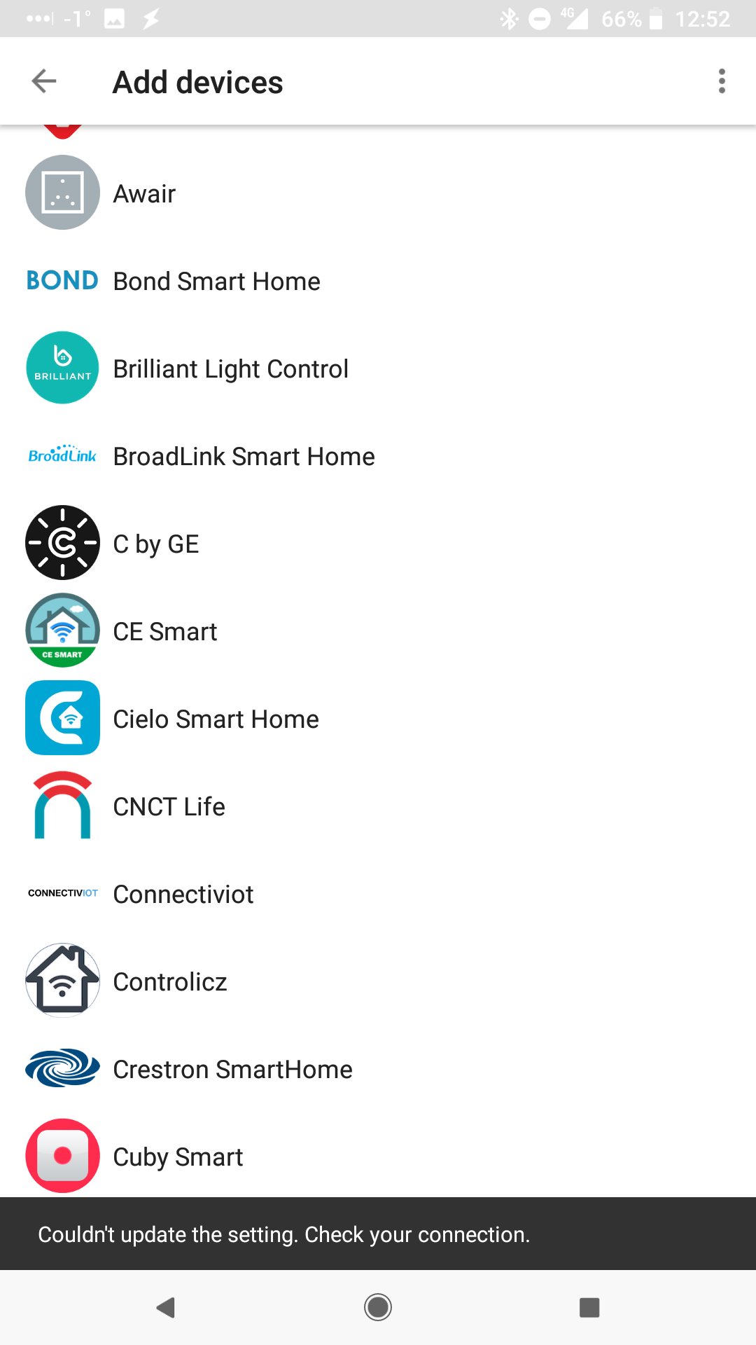

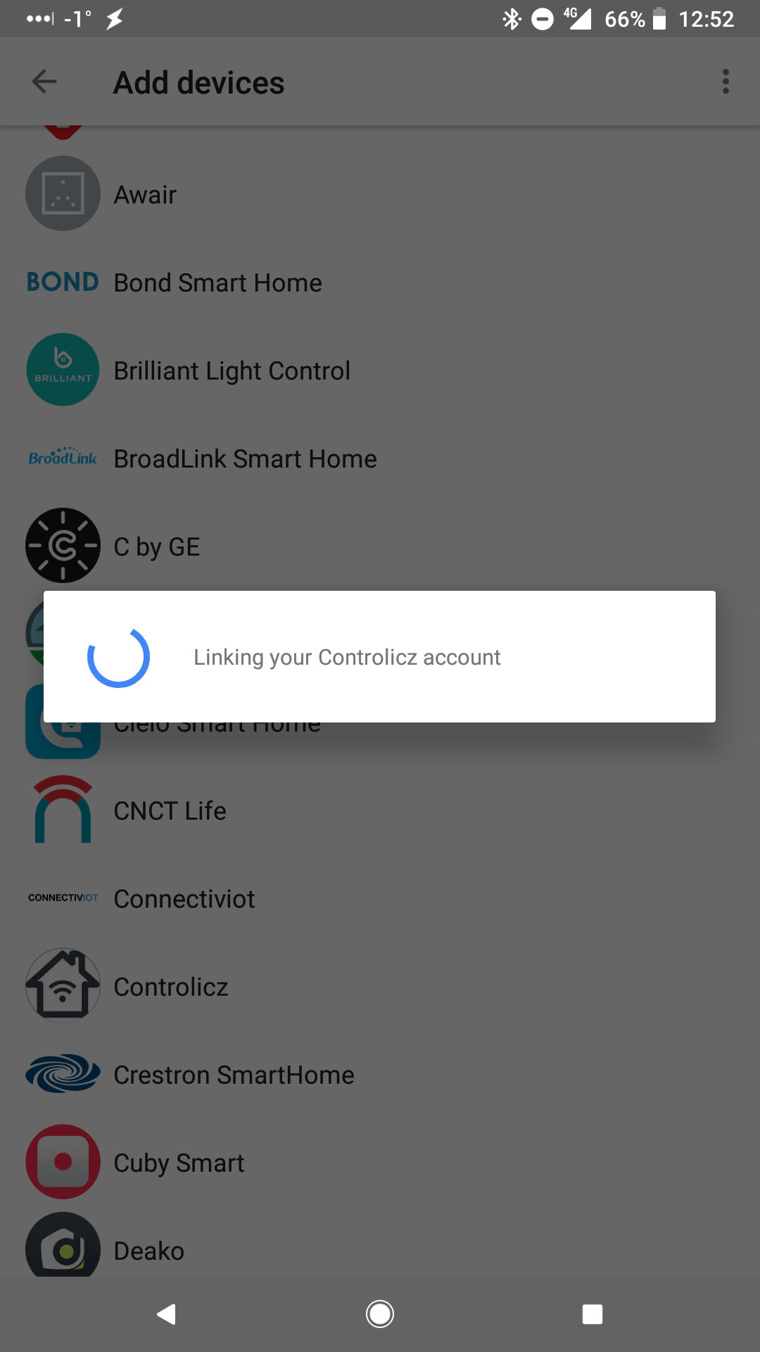

When I try to connect the account in the Google Home app, I get a message that Google needs full access to my account, I press allow, then in the end I get a message that it could not connect, and that I need to check the connection..

I have attached some screenshots of the results I get when testing in my profile, and adding it in the Home app.

please remove "https:/" from your hostname in Controlicz
I honestly thought i'd fixed that in the back end, but you just need to supply host name/external IP

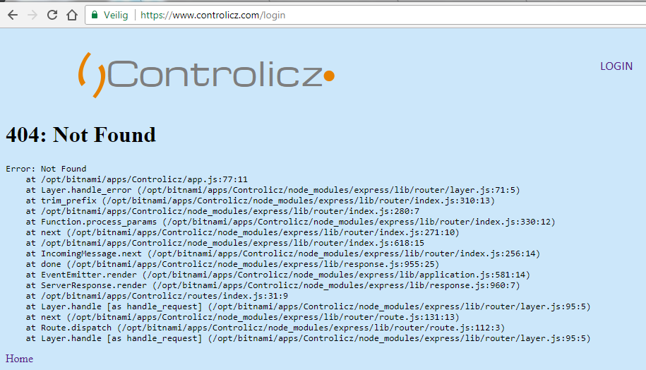

Will do that when your website works again, I now get 404 errors on the login screen..
- Capture.PNG (55.81 KiB) Viewed 2998 times

Are you hammering f5??! It's back.
Edit: For the wider community - Controlicz as a service to you wasn't down, rather the website was whilst I made a couple of changes. It was down for roughly 5 minutes.

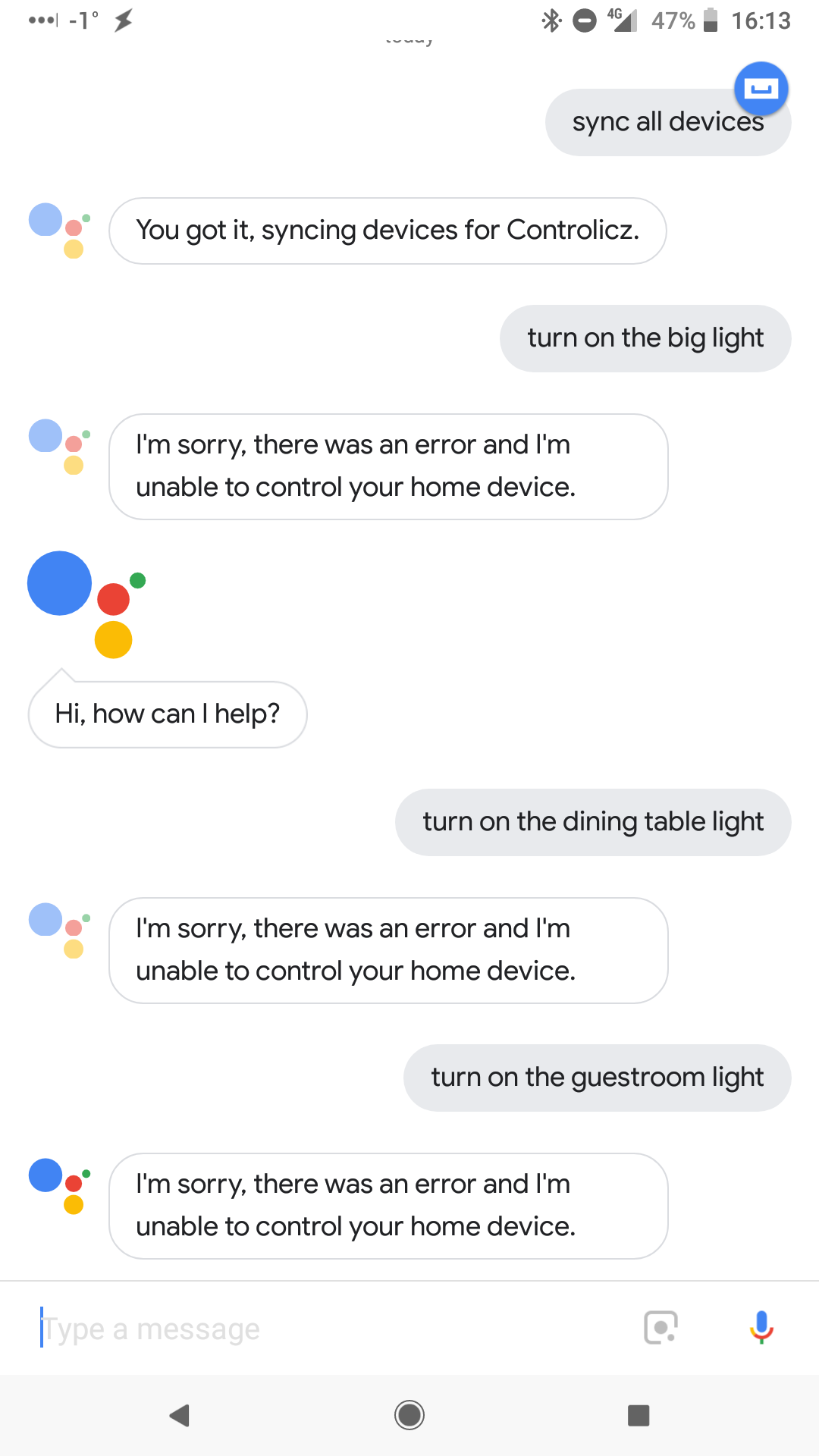

Sorry for all the questions from my side, but I'm almost there.. I have removed the https:// part and have successfully added it to Home now.. But... When I query something, I get the error shown in my screenshot.. Do you have any idea how to resolve that?
I already tried to unlink and link again.
Thanks a lot for the support so far!
[edit]
Some additional info:
I can query the status of a light; when I ask "is the big light on?" it will give me the current status of the light. If I turn it in Domoticz, the status will change. So the connection is there. For some reason it can not turn lights on or off though...
- Screenshot_20180226-161401.png (141.33 KiB) Viewed 3104 times

and those devices are discovered?
Re: Controlicz - Domoticz to Google Home/Assistant integration
Yep, they are discovered, and assigned to rooms
Tried some other commands, and setting them to a colour does seem to work:
Me: Set the big light to blue
Assistant: OK, changing the Big Light to blue.
I can see in Domoticz that it is turned on, and it seems to be blue. But since I am not at home, I can not really check.
