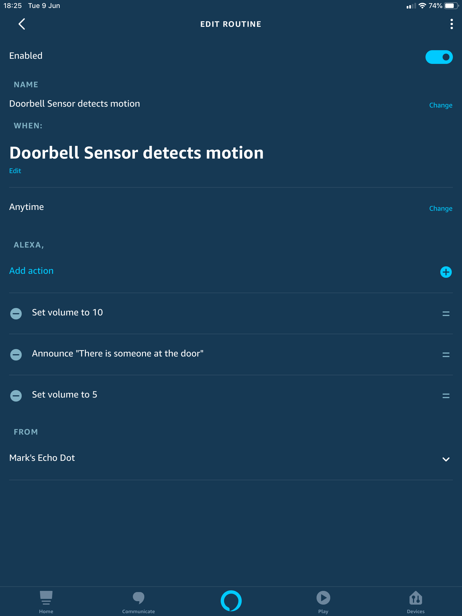

I have a dummy motion sensor set up to trigger a routine in Alexa. I can see the dummy sensor in Alexa change state but the routine does not fire.
The routine works fine if i trigger it manually in the Alexa app.
Any ideas as to why Alexa ignores the state change of the dummy sensor?

if you go into the routine, is the device listed ok and the routine enabled?
sundodger
Posts: 29
Joined: Sunday 11 August 2019 17:24
Re: Controlicz - Easy Domoticz to Alexa Integration
Post by sundodger »
Yes from what i see, see pic. As mentioned i see the dummy sensor change to motion detected. But the routine does not trigger

Hi Madgeni, not sure I understand your question. I may be confused as to how this should work.
The dummy sensor works. I see it state change in Domoticz.
This is mirrored in the Alexa app showing motion on the dummy sensor.
So the info is going from Domoticz to alexa ok. After that nothing happens with the routine pictured above. It does not trigger.
I may be missing something simple?

Hi - it's easy, but not obvious :)
So when you select the sensor in the app, it's querying it and pulling back the state - hence why it shows it correctly. However, you also need to let Alexa know when the state changes proactively - to do this you need to make a couple of changes on your Domoticz (lifted from the Controlicz FAQs):
In Domoticz – under Settings>Notifications:
For http - Put the URL: https://www.controlicz.com/notify/controliczID - for controliczID check your Controlicz profile – it will be something like 5b55b8e423e11e23de4f454d5 (e.g https://www.controlicz.com/notify/5b55b ... 3de4f454d5)
In the POST data box put: message=#MESSAGE and ensure Content-Type is application/x-www-form-urlencoded
Then in your sensor – under notifications put: A|idx|$value|Motion or Contact as appropriate – eg. A|123|$value|Motion , and enable the http toggle (disable the rest)
You will need to disable/enable Controlicz skill in your alexa app (this is a one time thing to create a new type of token).
then it should work. If you get stuck, just contact me from your Controlicz profile :)

I would like to thank Madgeni, the above and a bit of one to one tuition and it is all working well.
Excellent support.
