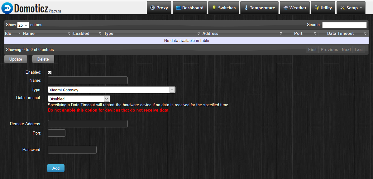

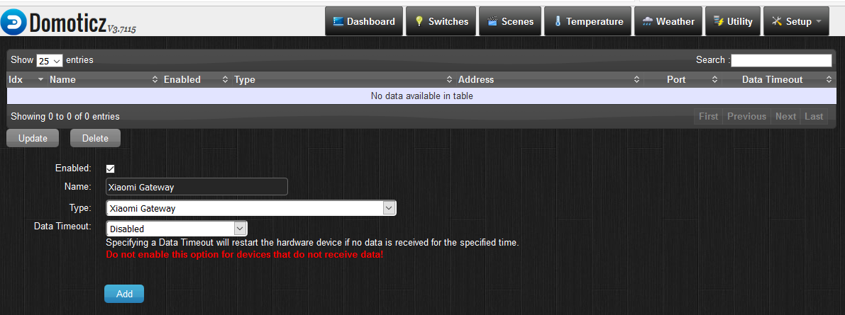

Hi Corbin,
In last beta 3.7115 could not to add Gateway, no way to enter IP, port and password
I was too lazy to compile from the sources and I used a short command
sudo curl -L install.domoticz.com | sudo bash
any ideas?
thanks
upd: but using my.domoticz.com I was able to add Gateway, bug or feature?

Coldman wrote:Hi Corbin,
99.9% chance your browser has cached old files, you need to force the cache to clear.
I'm using the Chrome extension "Cache Killer" that you recommended, I also tried Firefox
corbin
Posts: 463
Location: Brisbane, Australia
Post by corbin »
Coldman wrote: I'm using the Chrome extension "Cache Killer" that you recommended, I also tried Firefox
I still think it is a caching issue. In Chrome, run developer tools and tick 'disable cache' under the network tab, then refresh the page - make sure you get the "Browser Cache is being refreshed..." message in the top right.
Ok, I will try
