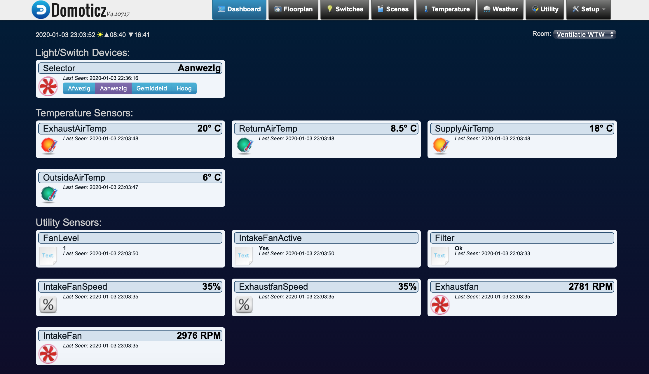

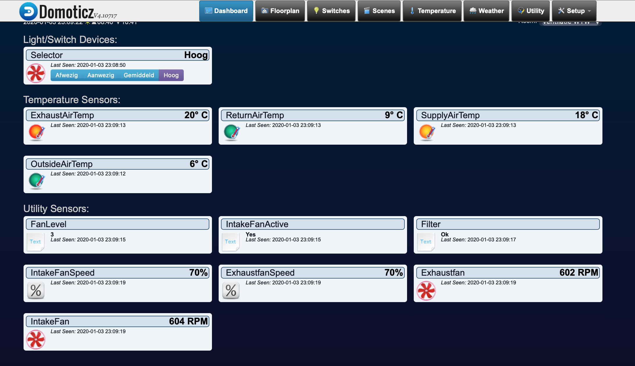

The implementation of my WHR930 works great for me. I needed a little bit more research but it was worth it.
I only have one problem, the RPM fan speed presentations arend working correctly. When i use the setting above 20% on the selector switch my fans are getting in a bad value for RPM presentation but the fans are speeding up correctly.
Normally the fan speed is +/- 2900 RPM by 35% fanspeed(selector 20%), but if i reach to fan speed 50% or higher (selector switch 30% or 40%) the speed is going down to 604 RPM.
The fan speed is really going up but something goes wrong on the serial communication for the presentation of the RPM.
Can someone suggest me what to try? Thanks!
P.S. I changed the intakefan/exhaustfan text sensors to a custom virtual sensor with RPM on the axis label and the Intakefanspeed/exhaustfanspeed text sensors to percentage virtual sensors. Now it is possible to log the values on a table. When i used the sensor as original text sensor i still had the same problem as above.
RPM by 35% fanspeed:
Schermafbeelding 2020-01-03 om 23.04.00.png (393.39 KiB) Viewed 5825 times
RPM by 70% fanspeed:
Schermafbeelding 2020-01-03 om 23.09.30.png (387.62 KiB) Viewed 5825 times

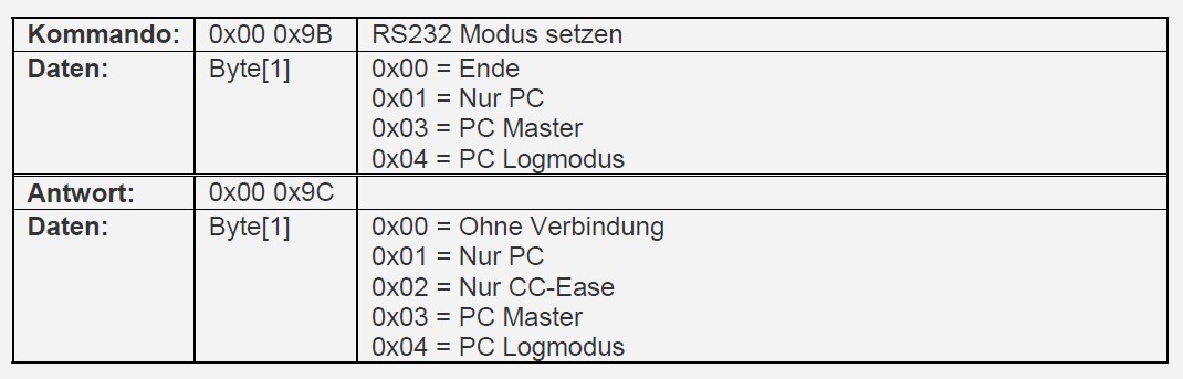

I use port DB9 on the PCB , but:
Limitations
Either the ComfoAir binding or the CCEase Comfocontrol can be active, but not together.
So in this case, there no way to use CCEasy and Domoticz / else ate the same time.
I wonder, beacouse the main board of 350luxe have conectors marked as RS485 ( CC Luxe).
Meaybe this is the way..

That's why the author of the OpenHAB binding has implemented a switch which controls if PC or CCEasy is controlling the unit. This should be possible also on other platforms
Btw, he has also implemented a mode switch - Exhaust&Supply, Supply only or Exhaust only. I can't figure out which commands he is using to switch this mode and I could not find it in the comfoair protocol document. Any ideas? Here is the github repo maybe you would be able to find it out in the code?
