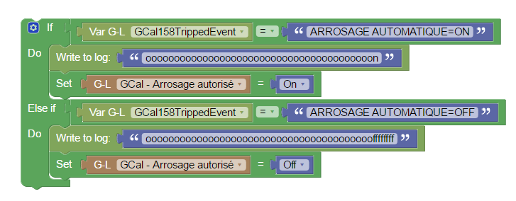

I can try your script's now but i cannot set on / off a virtual device.
I created one virtual device for this special use. I need to set on my wather gerden system from april to september to allow it. i've created two events on google calendar and i can get it correctly on Domoticz.
I have created a blocky for test this using a uservariable GCal158TrippedEvent to set on my device.
Wehn i change manually the value of this uservariable ( to "ARROSAGE AUTOMATIQUE=ON" or "ARROSAGE AUTOMATIQUE=OFF", the blocky works but it not work automaticly when your script make the change of uservariable GCal158TrippedEvent !
Have you any idea wath append?
here my blocky
here the log

here the log when i change manually the GCal158TrippedEvent
2016-04-15 06:16:32.559 ooooooooooooooooooooooooooooooooooooooooffffffff
2016-04-15 06:16:32.560 EventSystem: Event triggered: GCal - Déclenacheurs_2
2016-04-15 06:16:33.456 (Capteurs perso) Light/Switch (GCal - Arrosage autorisé)
2016-04-15 06:17:31.568 oooooooooooooooooooooooooooooooooooooooon
2016-04-15 06:17:31.570 EventSystem: Event triggered: GCal - Déclenacheurs_1
2016-04-15 06:17:31.729 (Capteurs perso) Light/Switch (GCal - Arrosage autorisé)
Your script work only with lua ? i need to make one or i can simply use blocky?

oxedgar wrote: Your script work only with lua ? i need to make one or i can simply use blocky?
I'm not a "blockly guy". I know that blockly had some issues before on reacting to changes to a virtual text device. But that is a pure blockly related question. I have no idea.
