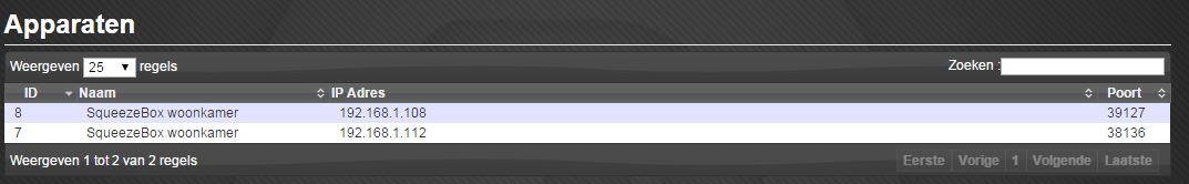

I got a new modem and reconfigured my home network. The squeezebox got a new network address resulting in a second device (in the switches screen). I tried removing it, that works fine.
In the hardware screen however, I still see 2 devices, how can I clean that up? Is it possible to not create a new device when the mac address stays the same?
- 2sb.JPG (35.53 KiB) Viewed 3238 times

Will look into that. Thanx for reporting!pvm wrote:I got a new modem and reconfigured my home network. The squeezebox got a new network address resulting in a second device (in the switches screen). I tried removing it, that works fine.
For now you can delete the LMS hardware and add it again to loose your 'old' player...

Fixed! Should be available in new beta...pvm wrote:I got a new modem and reconfigured my home network. The squeezebox got a new network address resulting in a second device (in the switches screen). I tried removing it, that works fine.
PS.: Still have to delete hardware and add again to get rid of the duplicate player for now. In new version it won't add a new player if the IP or Name changes...

Thnx, removed the hardware, readded and back to one device againEduard wrote:Fixed! Should be available in new beta...pvm wrote:I got a new modem and reconfigured my home network. The squeezebox got a new network address resulting in a second device (in the switches screen). I tried removing it, that works fine.
