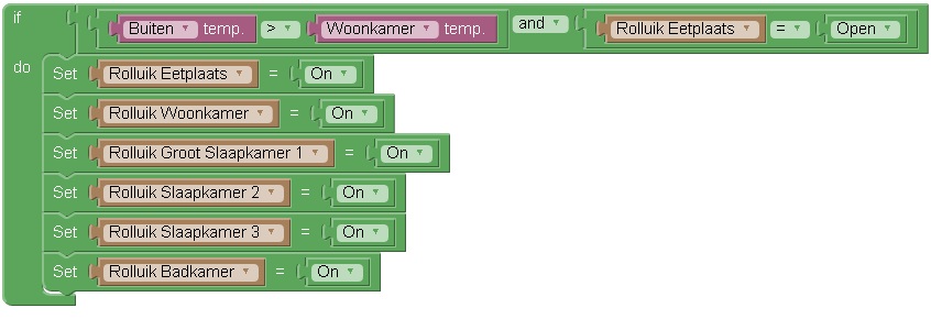

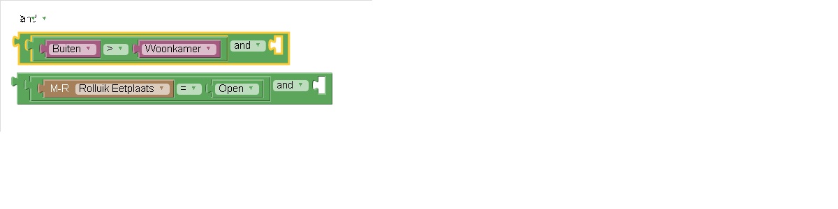

capman
Posts: 166
Location: Belgium
Events blokly graphics error
Post by capman »
I have a problem after my update to v887 in blokly.
Before a have this >
But after the update a got this >
When a do a new event and a save it , i have the same problem. All is scrambled.
I use windows firefox. Must a wait for another update to fix this ?
btw , nice program , keep up the good work.
CopyCatz
Developer
Posts: 123
Joined: Thursday 11 July 2013 17:28
Location: Outer Heaven
Re: Events system feedback thread
Post by CopyCatz »
The block stucture has changed from 873 onwards. You have to rebuild your event blocks.
