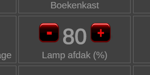

pff, took some time, but dimmer is working as I want it.
Just the icons are not completely ok yet.
But dimming up and down works fine now.
Pitfall was that the dimlevels in Domoticz are in values from 1 to 16 and displayed in values from 0 to 100 %!!
Yet another change, in the min part I change the line to, the 'rounding' takes care of going down one level at a time:
var d = ((level )/100*16) ;- Attachments

I have my version ready for use.
(I see now that jan_nl also created a solution, I have not checked it yet)
It includes dimmer buttons (also for thermostats) and the optional indication of the 'last seen'.
See the read me file in the attachment.
I found out that the dimming range depends on the device, you can now set the step interval accordingly.
Some dimmers have a range between 1 and 16 (default), other 1 to 100 (like Hue).
You can choose the step size yourself to account for this and use whatever step size is convenient for you.
I have no controllable thermostat myself, so others have to verify if it works for those devices.
You can also turn off a dimmable device by clicking on the value, so it leaves the current dimming value intact.
And when it is off, it will show 'Uit' instead of the dimming value (yes it can have a dimming value while off).
Colors change accordingly.
