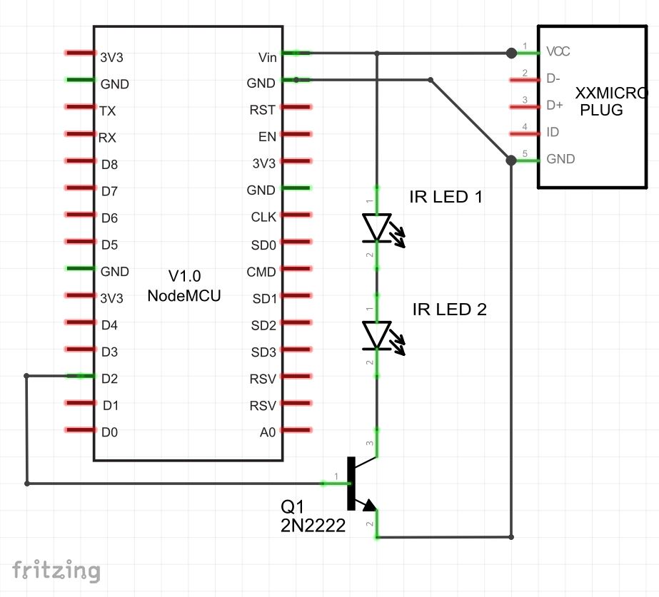

ESPEasy has got and IR transmit plugin for a while but I never been able to make it work.
Now with rev 124, it as been integrate and I'am glad to say that it works well.
Get the last Espeasy here : https://github.com/ESP8266nu/ESPEasy and configure it for your wifi network.
Create a device, select Infrared Transmit in the menu.
Choose a name and GPIO according to your wiring.
Schematic : When done, in your browser use this synthax : http://DEVICE_IP/control?cmd=IRSEND,IRtype,IRcode,bitsencoding
IRtype available : NEC, JVC, RC5, RC6, SAMSUNG, PANASONIC, SONY
IRcode : the code you have learn with a ir receiver using the Infrared receive plugin or an arduino for exemple
bitsencoding : 32 for example for a 32bits encoding
Example : http://192.168.1.12/control?cmd=IRSEND,NEC,61D608F7,32
