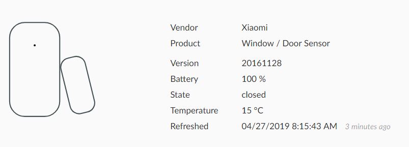

However, today I bought 2 aquara door sensors and in deConz is see that they have temperature sensors as well.
How do I add them to my temperature devices?

Hello, I haven't add them in the plugin because they are not reliables.
You have them on all Xioami device, but if you check the temperature you will see all possibles temperatures. Some of them they take the temperature of the door, or it never moves, or you can have hallucinating values.
On my side I have 28°C on the vibration sensor, 23°C on the motion and door sensor, while I have 21°C on the MultiSensor sensor, and they are at 3m each other.

Yeah... I see that... One of the sensors show 21 and the other shows 28 ... and they are like 30cm apart.
