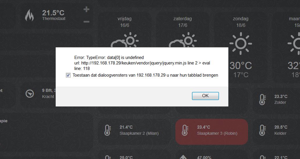

Get some error in my dashticz frontpage. Browser firefox and also on chrome.
- dashticz error.JPG (77.77 KiB) Viewed 3563 times

Re: Dashticz - Bug report
Is it possible to find out wich device causes this problem?capman wrote:Get some error in my dashticz frontpage. Browser firefox and also on chrome.
Maybe by removing each IDX from your config.js one by one?

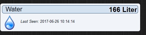

My Domoticz dashboard shows: Using the latest beta Dashticz shows: I do not need "Total water", but I need the space of the block urgently. How can I fix that?robgeerts wrote:Fixed in latest beta!Hesmink wrote:With the latest beta, all my RFXMeter counter type blocks, generate a third block with 'undefined':
In Dashtics:
In Domoticz default:
This is tested with a default config, with only the Domiticz ip and port modified.
