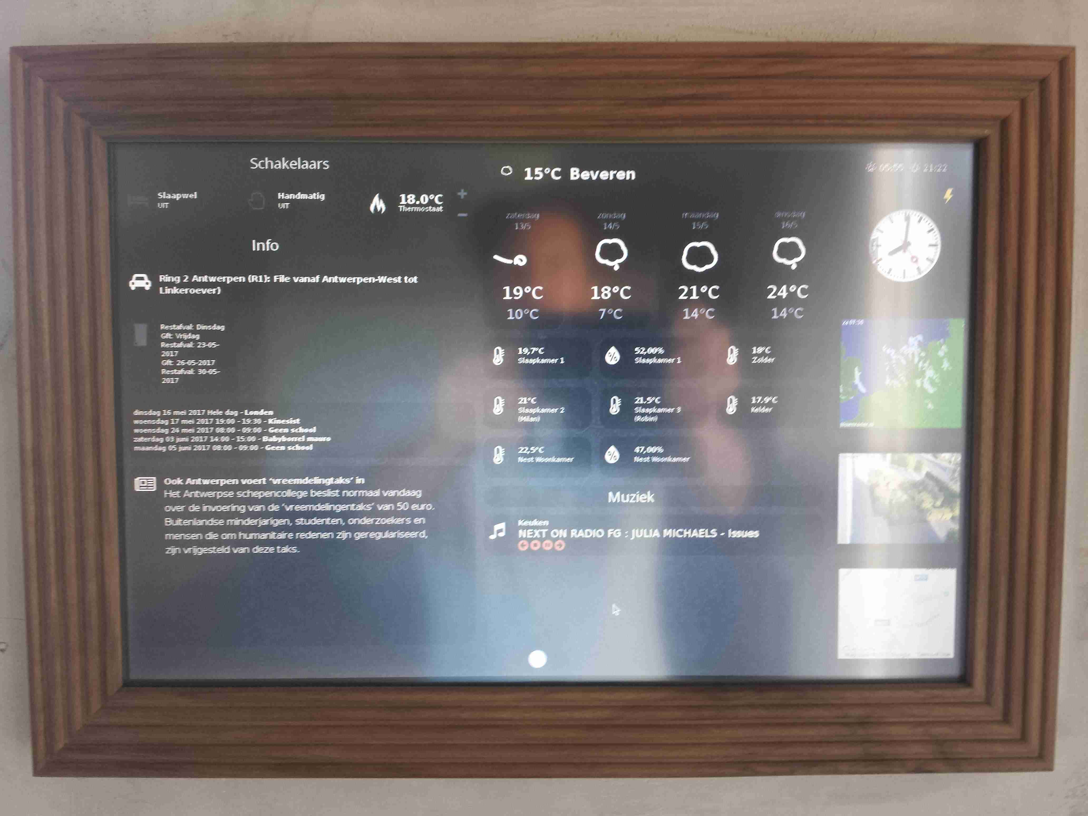

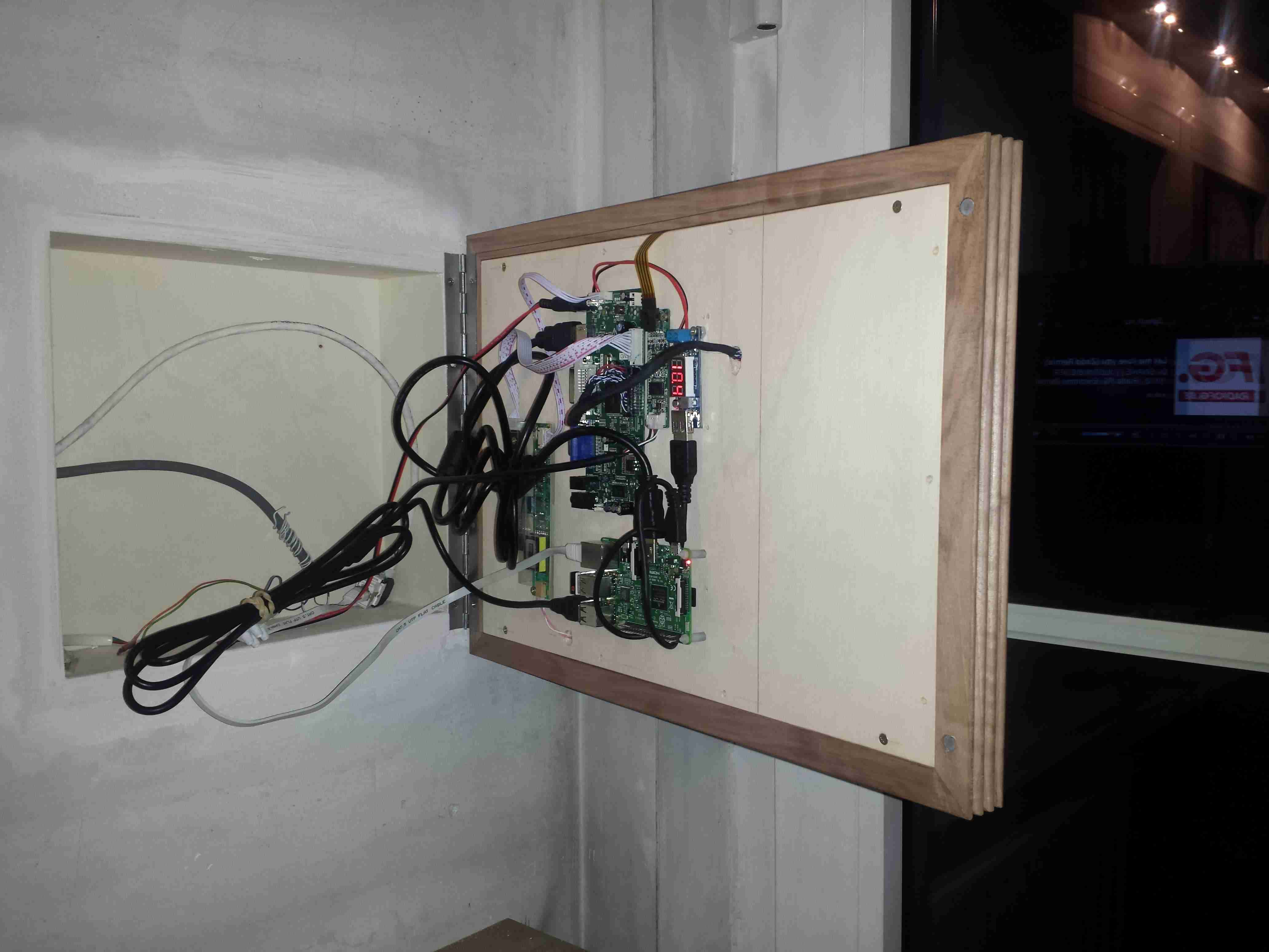

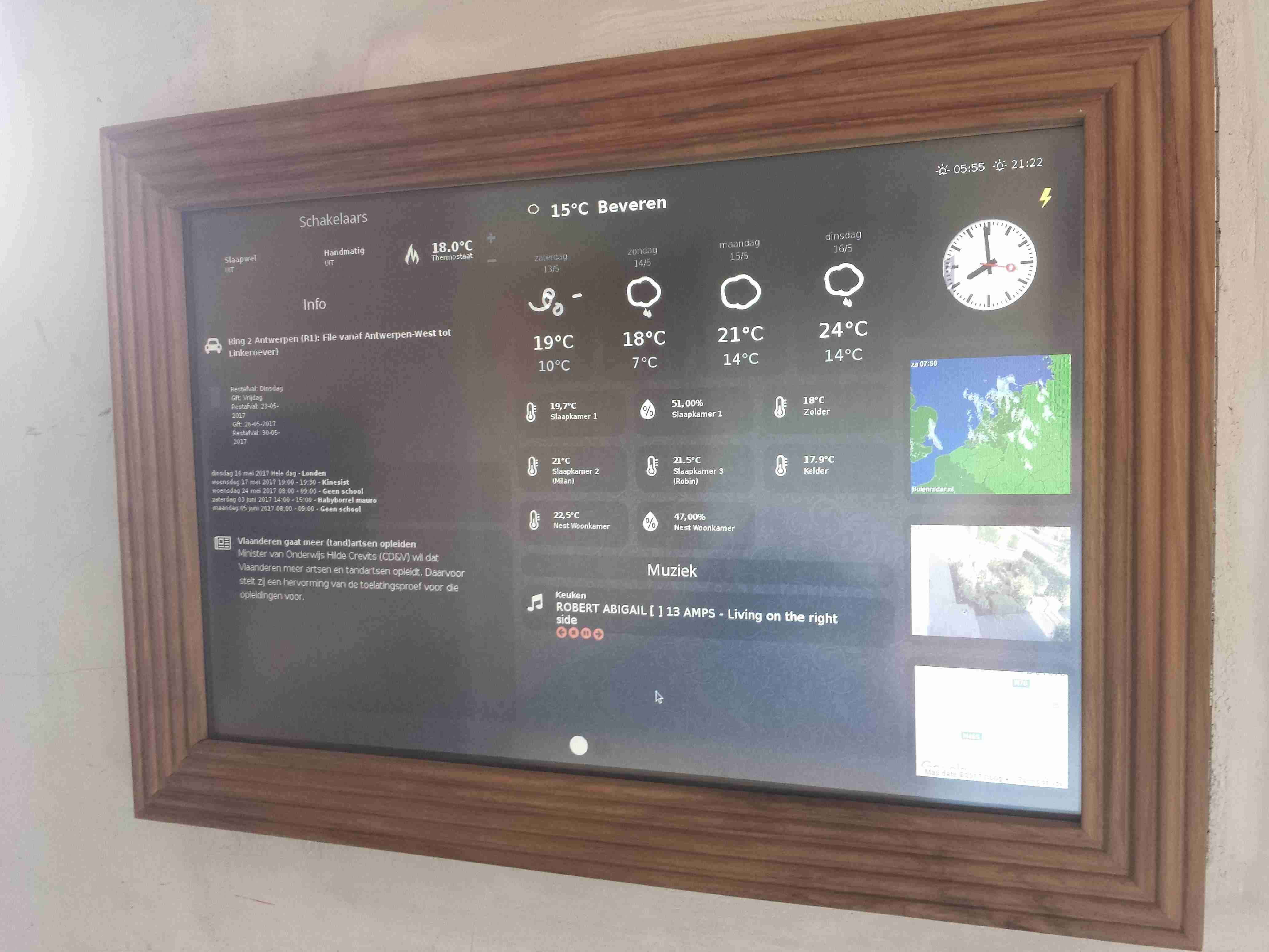

Some pictures of my Dashticz project , in my kitchen , so far

Looks great... But what's all that hardware and what screen did you use?capman wrote:Some picture of my Dashticz project , in my kitchen , so far![]()

Neat

I see a PI, arduino uno ? All of the rest i dont know, hahaha.wizjos wrote:Looks great... But what's all that hardware and what screen did you use?capman wrote:Some picture of my Dashticz project , in my kitchen , so far![]()

That looks like a Raspberry Pi with a external board to hook up about any screen you can find. On the outer left there's the backlight pcb for the screen. The led board is unknown but next to it is the pcb for the toucscreen.

That's right ! A use a raspberry pi 3 with debian jessie pixel. It have chromium browser installed as default. For the screen a use a laptop screen (17 inch) with a touchscreen before installed. A found the instructions on http://www.instructables.com/id/Touchsc ... -Control-/Ierlandfan wrote:That looks like a Raspberry Pi with a external board to hook up about any screen you can find. On the outer left there's the backlight pcb for the screen. The led board is unknown but next to it is the pcb for the toucscreen.
I want also one in my bathroom and bedroom. Also to control my multiroom music system. But that's in progress ... (http://www.domoticz.com/forum/viewtopic ... 60#p134389

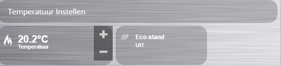

@pvdhelm, I've looked into this and can you try put this in your custom.css:pvdhelm wrote:it doesnt work here don't see any difference
/* Transparent background for buttons Thermostat */
.input-groupBtn .btn-number {
opacity: 0.5;
color: white;
background-color: rgb(34, 34, 34);
border-radius: 0px;
padding: 6px 10px 6px 10px;
line-height: 20px;
background-color: transparent;
}Hardware:

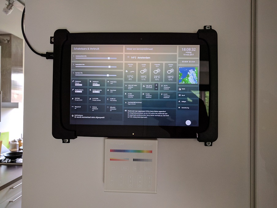

My setup so far. It's a Nexus 10 tablet in a 3D printed wall mount.

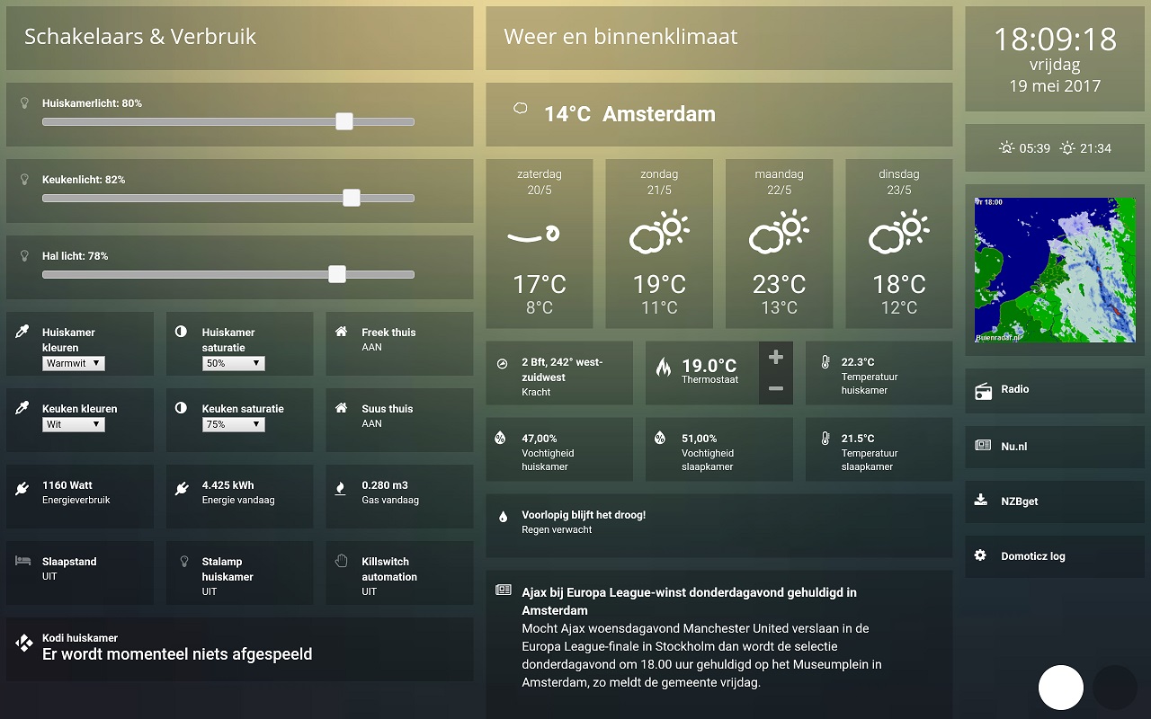

Screenshot:

Nice...

Tnx @htilburgs
this works for me
