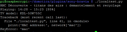

Sorry for this beginner question but it would be very nice if someone could help me.
I'm trying to use this plugin for my Sony Bravia TV
Python seems to be Ok
On "Setup" "Hardware" I see a Sony Bravia TV (with Kodi remote)
But nothing about changing parameters like IP address PSK ...
So i choose to clic "add" and in the list button setup does nothing.
In the log in can find :
If i try localtest.py I get
I've done all the setup on my TV a KDL-50W755c
Thanks in advance
2017-08-05 18:25:02.759 PluginSystem: Started, Python version '3.4.2'.But nothing about changing parameters like IP address PSK ...
2017-08-05 18:32:59.264 Error: () failed to load 'plugin.py', Python Path used was ':/usr/lib/python3.4/:/usr/lib/python3.4/plat-arm-linux-gnueabihf:/usr/lib/python3.4/lib-dynload'.
2017-08-05 18:32:59.264 Error: (Sony) Module Import failed, exception: 'ImportError'
2017-08-05 18:32:59.264 Error: (Sony) Module Import failed: ' Name: plugin'
2017-08-05 18:34:00.734 Error: Sony hardware (25) thread seems to have ended unexpectedly Code: Select all
No reaction of TV, assumed is off
TV status : offThanks in advance

I have just updated and have the exact same error. Any idea's anyone?lmet wrote:Hi,
Python seems to be OkOn "Setup" "Hardware" I see a Sony Bravia TV (with Kodi remote)Code: Select all
In the log in can find :If i try localtest.py I getCode: Select all
2017-08-05 18:32:59.264 Error: () failed to load 'plugin.py', Python Path used was ':/usr/lib/python3.4/:/usr/lib/python3.4/plat-arm-linux-gnueabihf:/usr/lib/python3.4/lib-dynload'. 2017-08-05 18:32:59.264 Error: (Sony) Module Import failed, exception: 'ImportError' 2017-08-05 18:32:59.264 Error: (Sony) Module Import failed: ' Name: plugin' 2017-08-05 18:34:00.734 Error: Sony hardware (25) thread seems to have ended unexpectedlyI've done all the setup on my TV a KDL-50W755cCode: Select all
No reaction of TV, assumed is off TV status : off
Thanks in advance
Cheers

@lmet, @simon_rb,
Please download plugin.py and bravia.py from https://github.com/gerard33/sony-bravia ... evelopment to see if that works for you.
That version works here without the error message on startup.
Edit: @simon_rb confirmed that version works, so I have pushed those changes to the master brance. The latest version of the plugin is now version 1.2.
