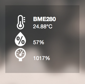

This dashboard is so far the best.
I combined temp+humidity+barometer:

hpapagaj wrote:This dashboard is so far the best.
Nice combo... Can you share the code how you solved this?
As i can't see if the icons are smaller or equally sized as the others...
And i also have a few sensors which i would like to combine in one box...
madrian
Posts: 231
Re: New Dashboard Design
Post by madrian »
Yes, it needs some tweaking to equally size icons. Maybe later I check this.
For BME280 dummy sensor:
in main.js find line
if(parseFloat(data.result[r]['Favorite'])==1){
few lines down find this line
$('.blocks').append(html);
after this you must add the following else if statement:
else if(data.result[r]['Type']=='Temp + Humidity + Baro' && data.result[r]['SubType']=='THB1 - BTHR918, BTHGN129'){
								$('.block'+data.result[r]['idx']).remove();
								var switchHTML = '<div class="col-md-4 mb no-pr" data-light="'+data.result[r]['idx']+'">';
										switchHTML+='<div class="transbg"> ';
											switchHTML+='<div class="col-md-4 padding-2">';
												switchHTML+='<em class="fa fa-thermometer-half fa-thermometer-half-switch"></em>';
											switchHTML+='</div>';
											switchHTML+='<div class="col-md-8 padding-2">';
												switchHTML+='<strong class="title">'+data.result[r]['Name']+'</strong><br />';
												switchHTML+='<span class="state">'+data.result[r]['Temp']+'°C</span>';
												switchHTML+='<em class="wi wi-humidity"></em>';
												switchHTML+='<br />';
												switchHTML+='<span class="state">'+data.result[r]['Humidity']+'%</span>';
												switchHTML+='<em class="wi wi-barometer"></em>';
												switchHTML+='<span class="state">'+data.result[r]['Barometer']+'%</span>';
								$('#switches').append(switchHTML);

Just a small observation on that amazing code, Barometer output should read hPa
robgeerts
Posts: 1273
Domoticz version: 3.7067
Post by robgeerts »
hpapagaj wrote: after this you must add the following else if statement:
Added this to my code at gitlab!
Ierlandfan wrote:Just a small observation on that amazing code, Barometer output should read hPa
Changed this to hpapagaj's code ;)

I forgot that I changed margin-left for the first icon (fa-thermometer-half-switch)
Line 46 creative.css:
.fa.fa-thermometer-half {margin-left:8px;}
after that add:
.fa.fa-thermometer-half.fa-thermometer-half-switch {margin-left:4px;}
There is a place for more cosmetic work:
-vertical-align middle for sensor values
-equally sized icons (I have a feel that the last icon is smaller than others)

hpapagaj wrote:I forgot that I changed margin-left for the first icon (fa-thermometer-half-switch)
Added!

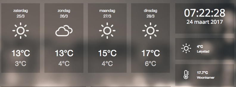

Hi Rob,
Is there a possibility to see the weather forecast of today?
Schermafbeelding 2017-03-24 om 07.22.21.png (197.15 KiB) Viewed 2442 times
My son asked me, the weater forecast for today and I only know the temerature at the moment
Gerard
Post by robgeerts »
Yes, replace js/weather.js with the new one (see attachment)

gjaa wrote:Hi Rob,
Gerard
Earlier, I mentioned I changed this, and I did, but from now on, it still starts with the weather of tommorrow after 15:00h
