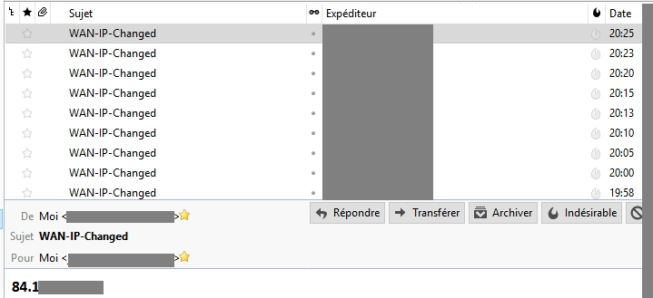

I have installed your plugin and I have a problem. I receive notifications every two minutes while my WAN-IP address has not changed.
My wife receives SMS with the same message also with the same frequency.
I disabled the plufin while waiting for a response.
thank you in advance
I forgot to tell that I have nothing on Utility tab.

Plugin posts 3 notifications/minute on debug mode.
You can either disable "debug" mode or "notifications"

Thank's a lot. Now waiting my IP to change ;)
