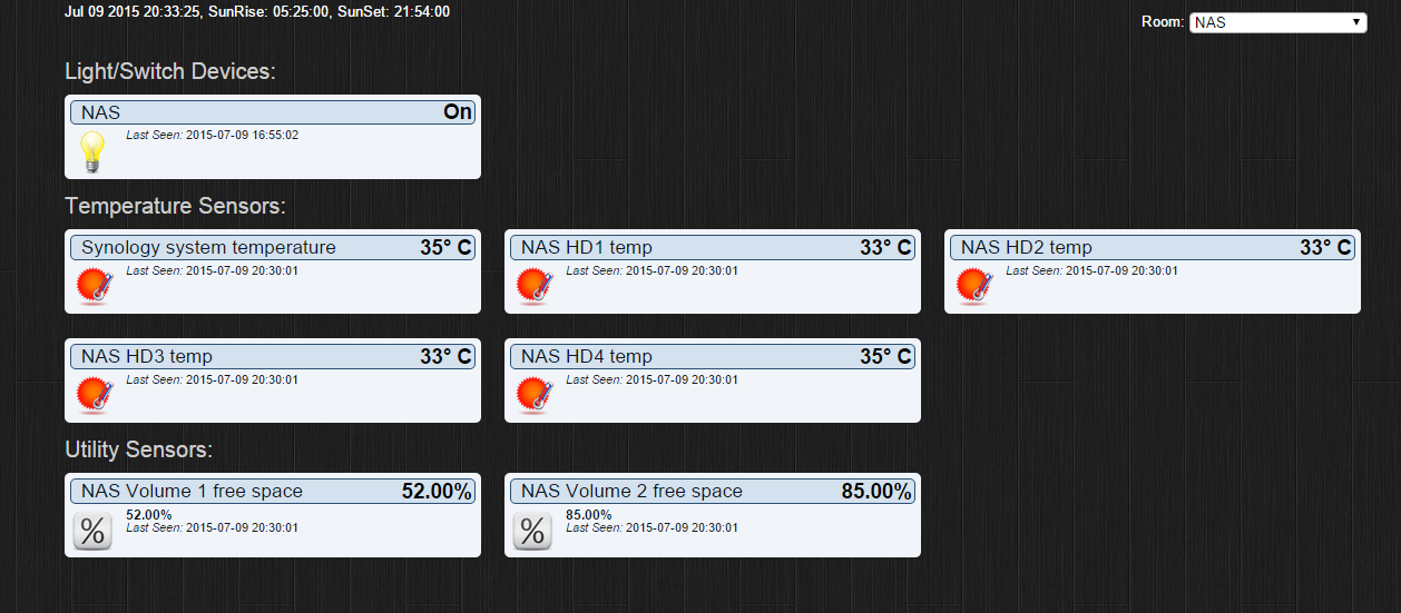

Have added this to my Domoticz, works like a charm
I added Volume2 to the list by just changing the .38 (Volume 1 on DSM 5.2) into .40
I also added the Syno system temperature from one of the earlier posts here.
To get free space I had however to do 100- the value calculated as the value calculated is the used space.
