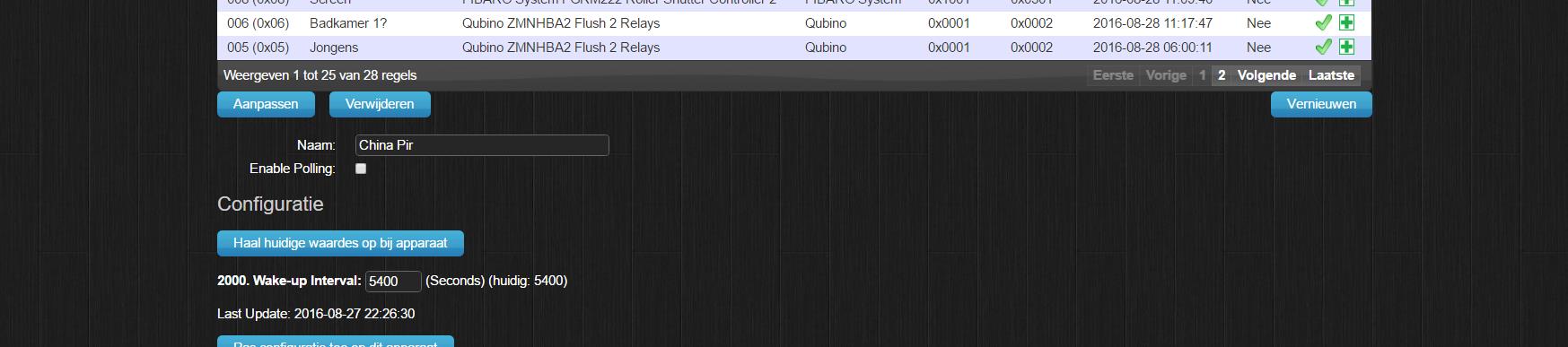

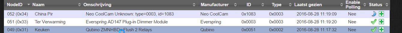

mmm Should this be ok?
Is perhaps the motion not include?
Because i see no settings:
Re: Cheap chinese z-wave products
Posted: Sunday 28 August 2016 16:01
by LouiS22
Derik wrote:mmm Should this be ok?
Damn, there's a typo in manufacturer specific xml (my mistake). I'm gonna provide an update to ozw, but it's gonna take time.
If you want to test drive, please edit your manufacturer specific xml and replace the 0 to 1 in the following line (the id should be 1083):
<Product type="0003" id="0083" name="Battery Powered PIR Sensor" config="shenzen_neo/nas-pd01z.xml"/>
