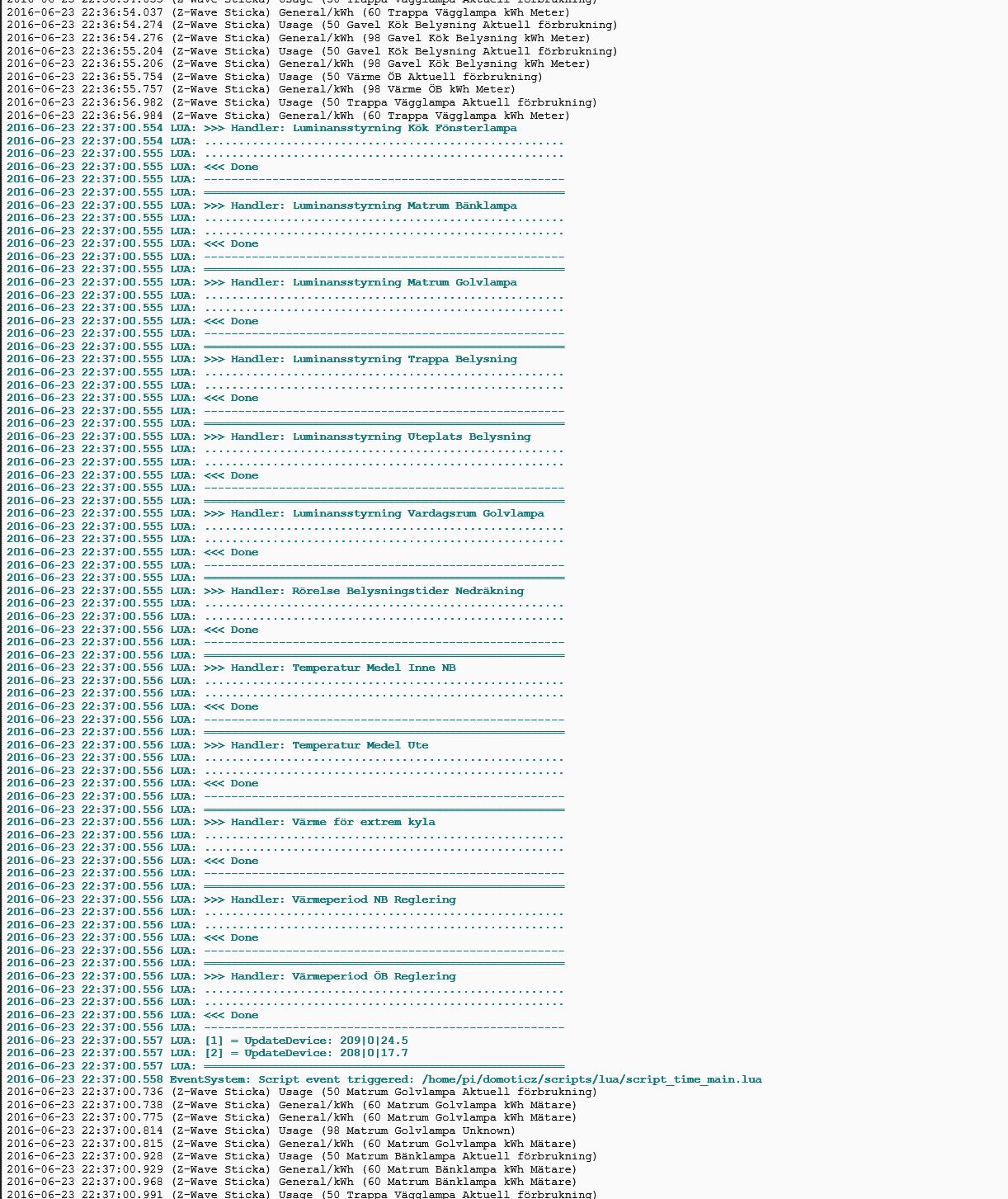

Magnificent works with dzVents. I love it. :)
But dzVents seems to be too fast to the log. Timer event needs to be more spread out in seconds or something? I have about 25 scripts that starts every minutes.
Only the last 9 to 12 will be notified in the log. The rest is overflow or something.
2016-06-23 Logg 01.JPG (386.44 KiB) Viewed 3147 times
Domoticz on Raspberry PI 3 since 2016.
dannybloe
Posts: 1355
Location: Ermelo
Re: dzVents 1.0 released
Post by dannybloe »
Yeah, I gotta make it more controllable. But you can change the logging to only errors in dzVents_settings.lua.
But indeed Domoticz cannot handle a flood of log additions.
