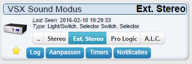

My wife is happy with me haha :lol:
Did the update's
I think the rescan is not working proppertlty

The bigger problem is that every 5 minuts he chances the input to the "level10" selecter of the audio modes.
I did make a dummy selecter with a code what the vsx does not reconize...
// Domoticz Audio Mode Selector - LEVEL : [MODE, NAME]
var modes = {
        10              : [ '9999', 'Dummy' ],
        20              : [ '0009', 'Stereo' ],
        30              : [ '0112', 'Ext. Stereo' ],
        40              : [ '0012', 'ProLogic' ],
        50              : [ '0151', 'Auto Level Control' ],
Not a very nice fix but it works for now.

And it looks like the level 10 bug is out of the way
2016-02-10 19:57:15.671 MQTT MSG: [HTC] Pioneer AVR is ON
2016-02-10 19:57:15.772 MQTT: Topic: domoticz/in, Message: {"command":"switchlight","idx":117,"switchcmd":"On"}
2016-02-10 19:57:15.773 (Dummy) Light/Switch (VSX Sound Modus)
