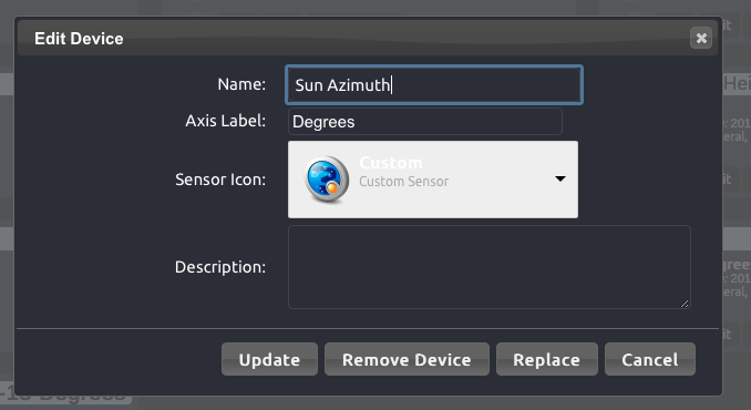

And Trixwood how did you name the Dummy's..
In the wiki are the names different...
Sun Azimuth or Solar azimuth and D or degrees
Sun altitude or Solar Altitude etc etc etc..

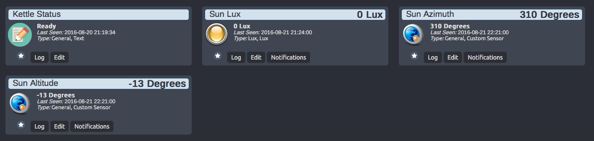

trixwood
Re: Real-time solar data : azimuth, Altitude, Lux sensor...
Post by trixwood »
Screen Shot 2016-08-21 at 22.21.32.png (73.69 KiB) Viewed 5173 times
Screen Shot 2016-08-21 at 22.20.50.png (43.5 KiB) Viewed 5173 times

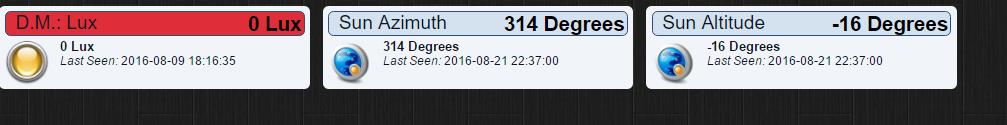

2016-08-21 22:39:00.833 LUA:
2016-08-21 22:39:00.833 LUA: 2016-08-21 22:39:00
2016-08-21 22:39:00.834 LUA: Nijmegen, latitude:59.87957, longitude:5.82391
2016-08-21 22:39:00.834 LUA: Home altitude = 5 m
2016-08-21 22:39:00.834 LUA: number Of Day = 234

Ok, so that works... now for the last part if you use the sensor from Weatherunderground hardware:
instead of:
   relativePressure = tonumber(otherdevices_svalues['Pressure SENSOR'])
use:
      temp, hum, uv, pres = otherdevices_svalues['Weather TempHumBaro']:match("([^;]+);([^;]+);([^;]+);([^;]+)")
      relativePressure = tonumber(pres)
Where "Weather TempHumBaro" is the combined temp/humidity/pressure sensor so we have to decode it...
Screen Shot 2016-08-21 at 22.44.56.png (28.2 KiB) Viewed 5164 times
